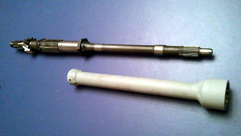

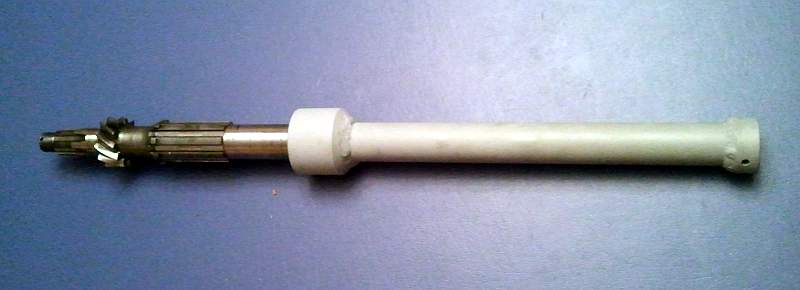

While the car is in for welding, I've been working to complete the 915. The problem with transmission rebuilding, is of course the need for a multitude of special tools. To torque on the nut for the main shaft, P 252A is required. We got a huge 1 5/8" socket from Sears ($20) and hacked it apart:
Lots of work just to put some torque on a nut, but works like a charm:
