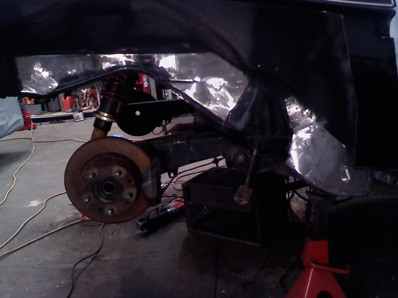

On to business. I have a 1974 914 (4742921095) that has been an AX car for the last ten years. My plan is to make the car more presentable--when I got it, it was quite rough. It's an SBC V8 build with a 915 transaxle and various 911 suspension parts. More about that later. The car doesn't look so good right now, in particular I don't like the flares, so I'm going to do a fairly thorough restoration. Not too much rust on the car, but it probably needs dealing with anyways. Here's the beauty:
(IMG:http://www.914world.com/bbs2/uploads_offsite/people.opera.com-10999-1290399407.1.JPG)
I bought this car from nocones last year, and it's been sitting for most of that time, due to a broken transmission (and also I've been back in Norway). During some fairly normal driving, it popped out of third gear and self destructed. I wasn't in the car at the time, so I'm not really sure what happened. Only inspection will tell.

for some odd reason the chassis rail from teh rt shock tower to the trans mound was hammered inward hard. it was flattened out very deep. WTF? tire clearance? ...but only on one side and it looks like it was hammered in

karlo   The car has found its way to Sean's shop where...   Jan 8 2011, 02:51 AM

sean_v8_914   compared to others, this chassis is fairly solid. ...   Jan 22 2011, 11:02 AM
sean_v8_914   the rust seems to weaken the spot welds. then they...   Jan 22 2011, 11:09 AM
