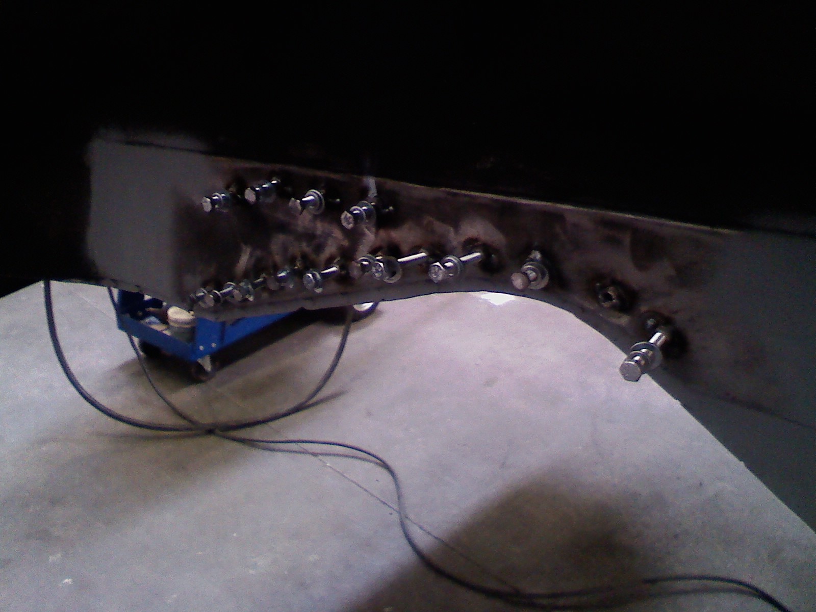

my harbour freight stud welder died so I welded on some franken-bolts to pull it out prior to adding th GT stiffeners. this is after seam welding. I better re-measure this after all the beating, pulling and welding
