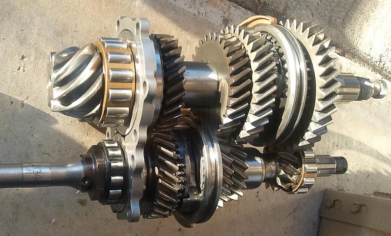

Gear stack going back in the transmission:
I opted to ditch the main shaft/1st gear I had and get a newer one which wasn't worn. As a bonus, it's the later stronger shaft (old was weaker revision 1), like brilliantrot pointed out earlier. Replaced the fourth gear as well, since the one I had was worn through the hardening. New thrust bearings, etc., and got the CMS one piece bearing retainer. Not many original parts left in the trans now. It should all make it better and stronger, though.
