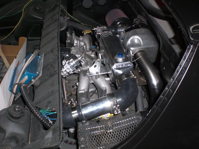

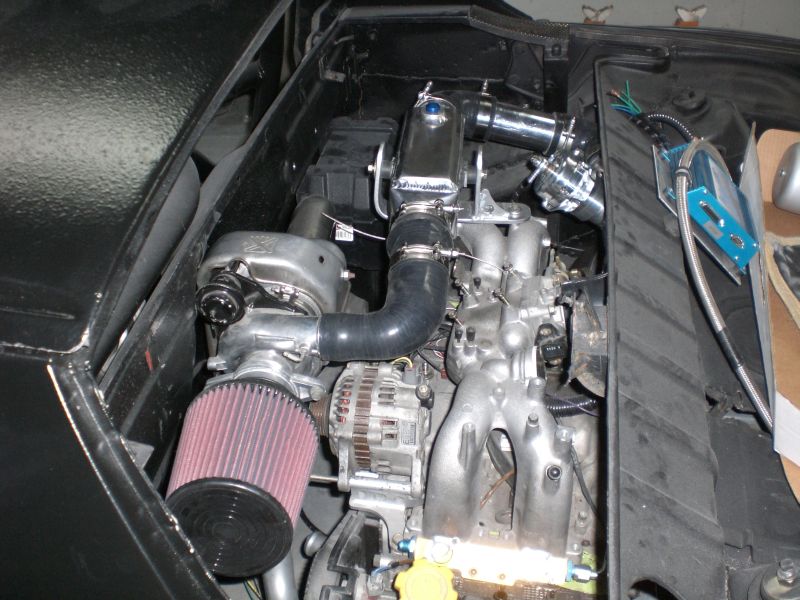

d914   ok been awhile but I have been working.. Four year...   Jan 30 2011, 07:10 PM
BIGKAT_83   Looking good lets see some pictures of the gas tan...   Jan 30 2011, 09:07 PM
Britain Smith   Very nice man. -Britain   Jan 31 2011, 12:32 AM
GS Guy   Where did you source the turbo cover? Looks good...   Jan 31 2011, 04:03 PM
d914   stock cover.. Stainless steel.. I just need to mod...   Jan 31 2011, 05:07 PM
kg6dxn   I'm using an air to water intercooler too. I h...   Jan 31 2011, 07:12 PM
d914   there is always a small oil cooler off the engine ...   Jan 31 2011, 08:35 PM
