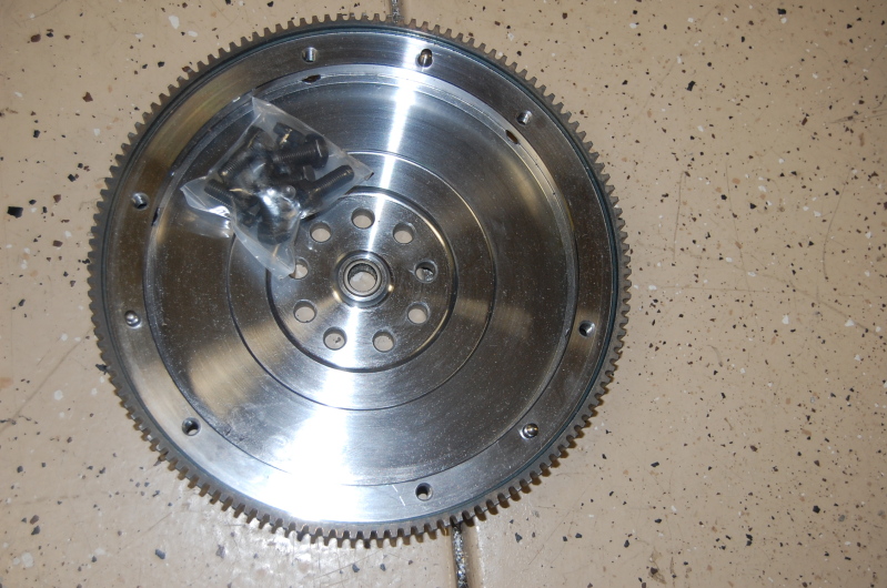

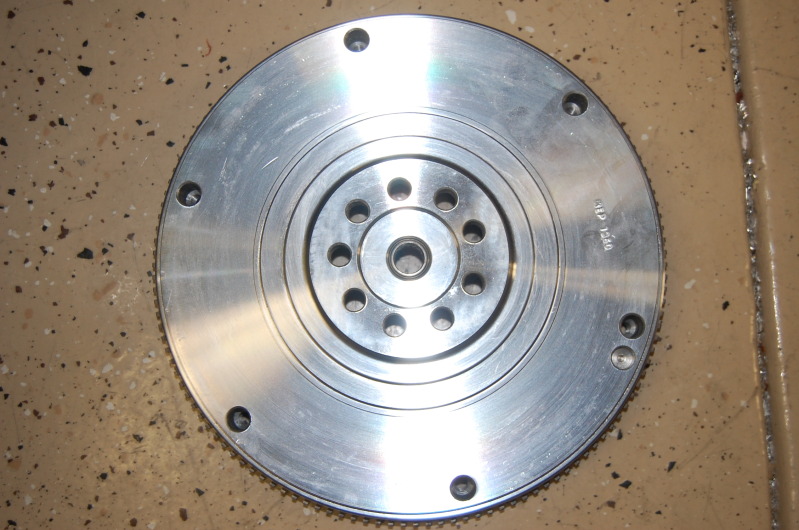

I got something in the mail last week. It's my 901 to 3.0 flywheel from Kennedy Engineering. They do good work. The flywheel came with bolts.

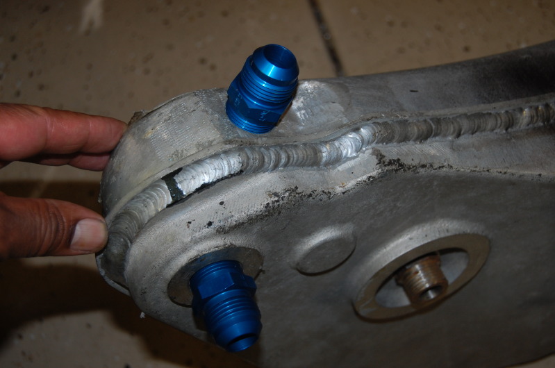

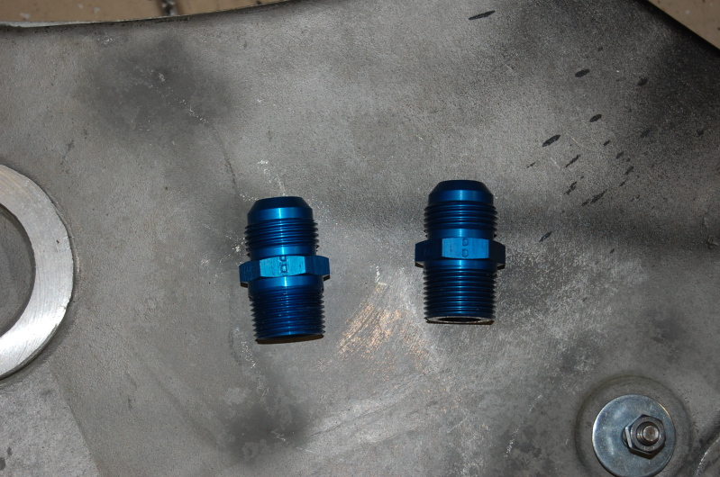

Also, while in LA last week, I stopped by Earl's plumbing to pick up a couple of 3/4' to -12 adapters for my Velios oil tank.
