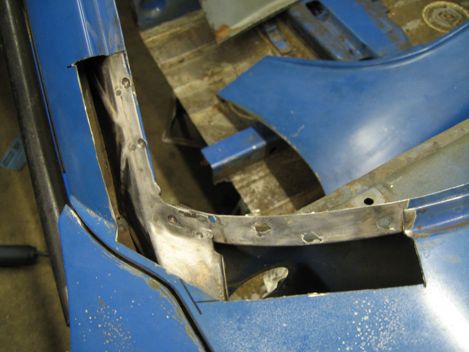

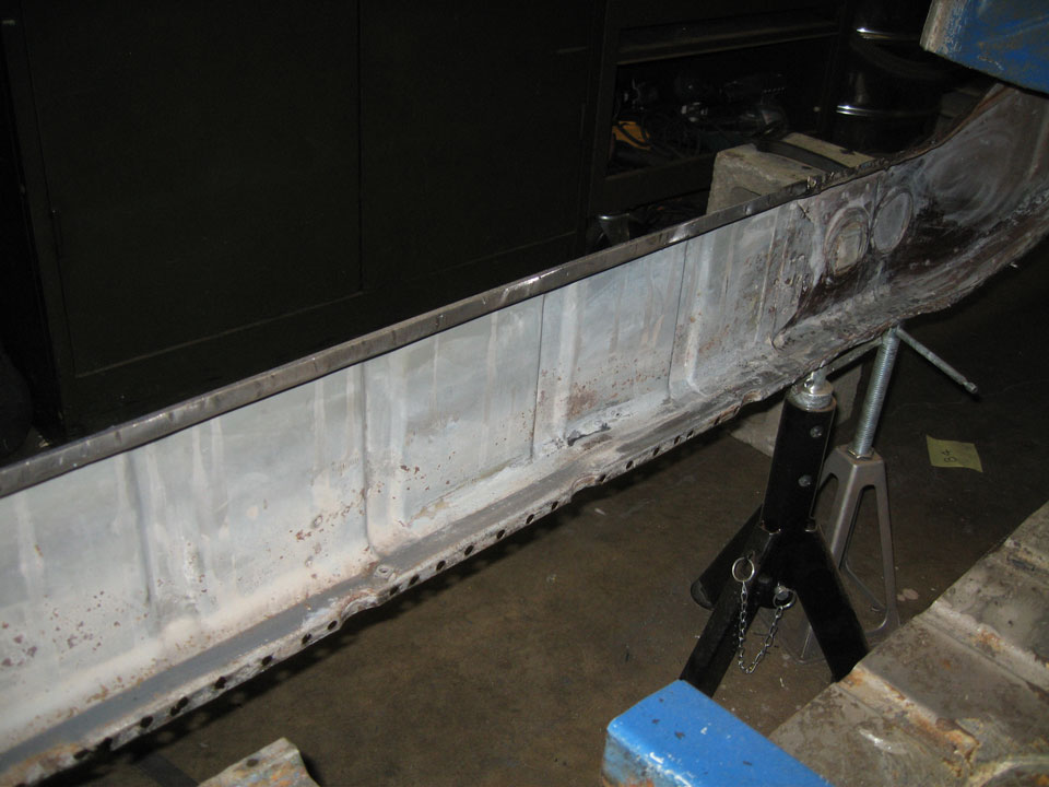

I almost got the impression I'd gone past the line of it being scary. The surface rust in the outer long isn't flattering. I sanded a bit of it, quite a lot of red powder, but I think I can save it. I put some rust dissolver phosphoric acid gel on it.
(IMG:http://www.914world.com/bbs2/uploads_offsite/www.914club.com-11782-1296535786.1.jpg)
I welded up the places where I drilled too far and smoothed em out. I had to do some pretty good metal adding as it did get kinda brutal.
I need to get media, I'm thinking glass bead so as not to make it any thinner... I have acquired this.

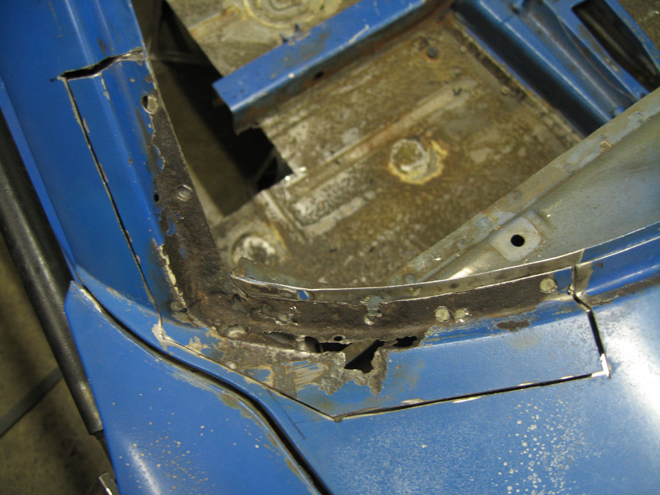

Oops I drilled through. I was supposed to be fixing like issues on the side of my firewall today, but I'm actually ill, sort of congested in my head (on one side only?)

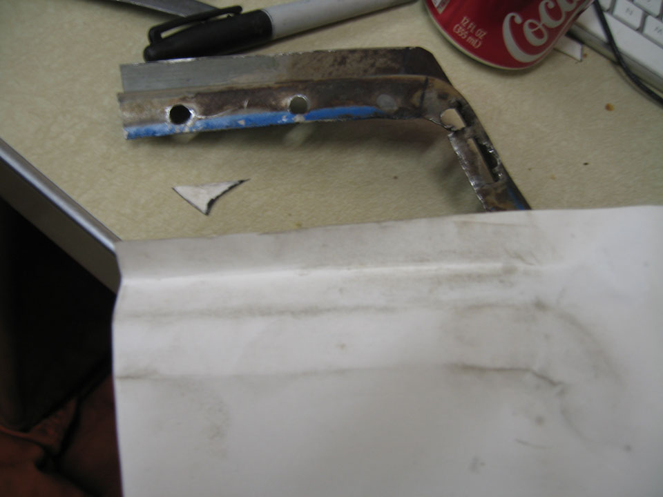

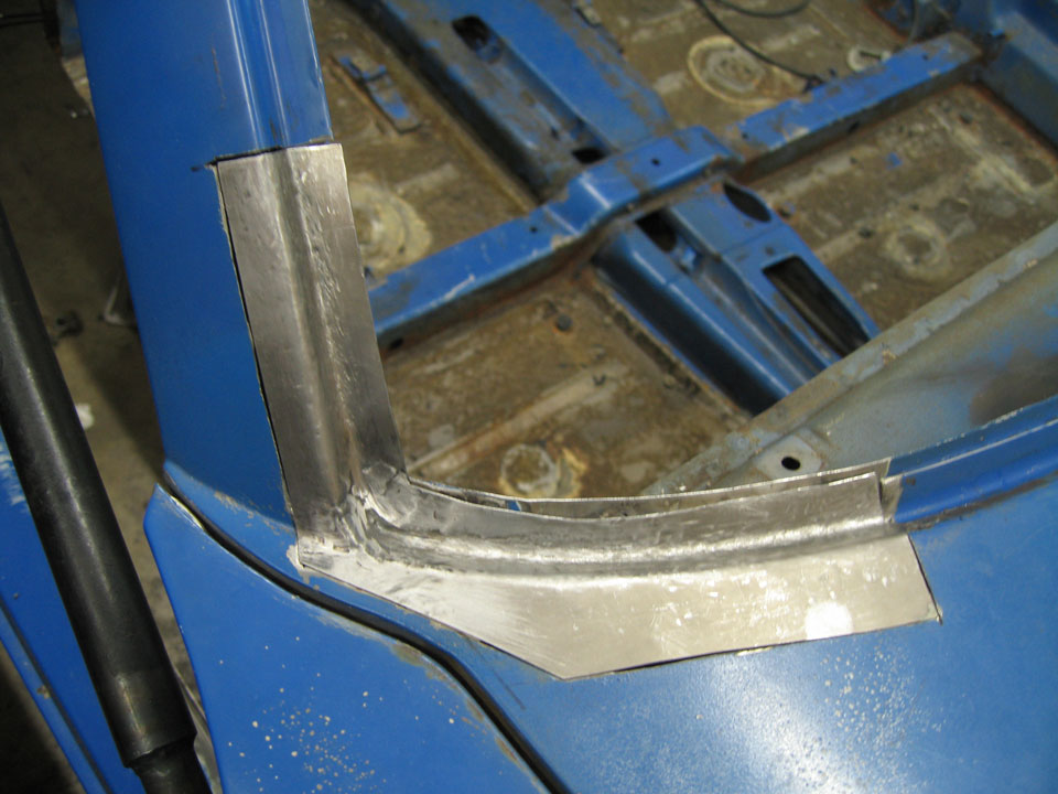

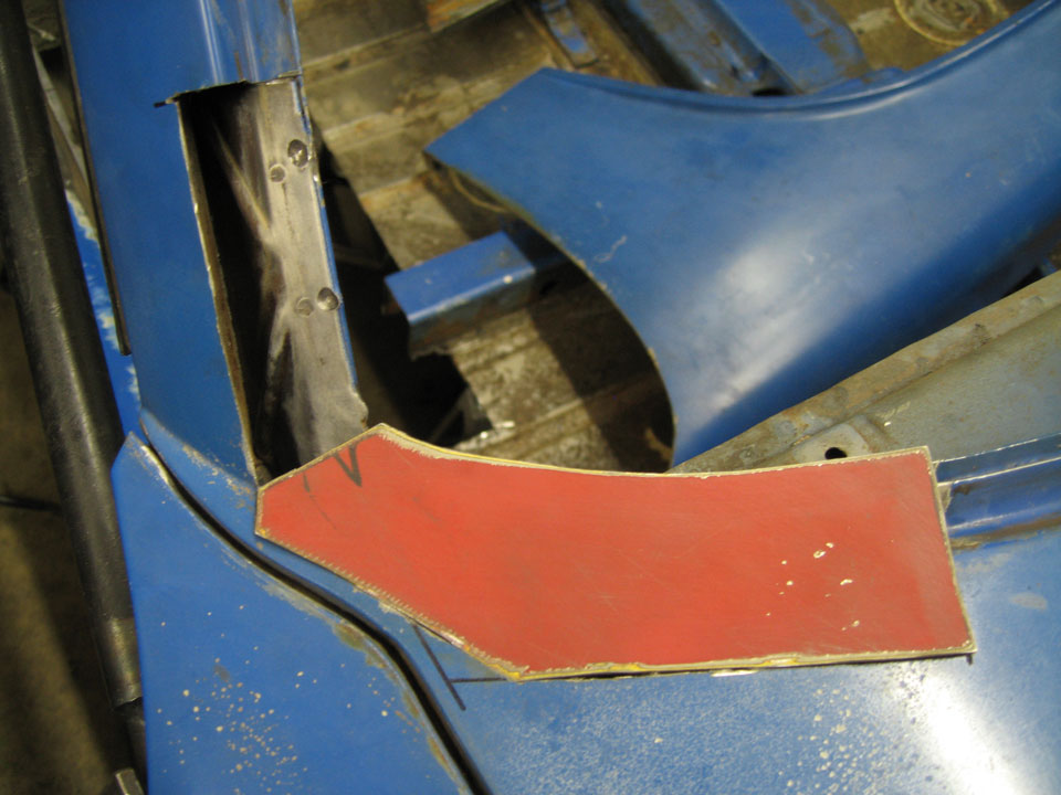

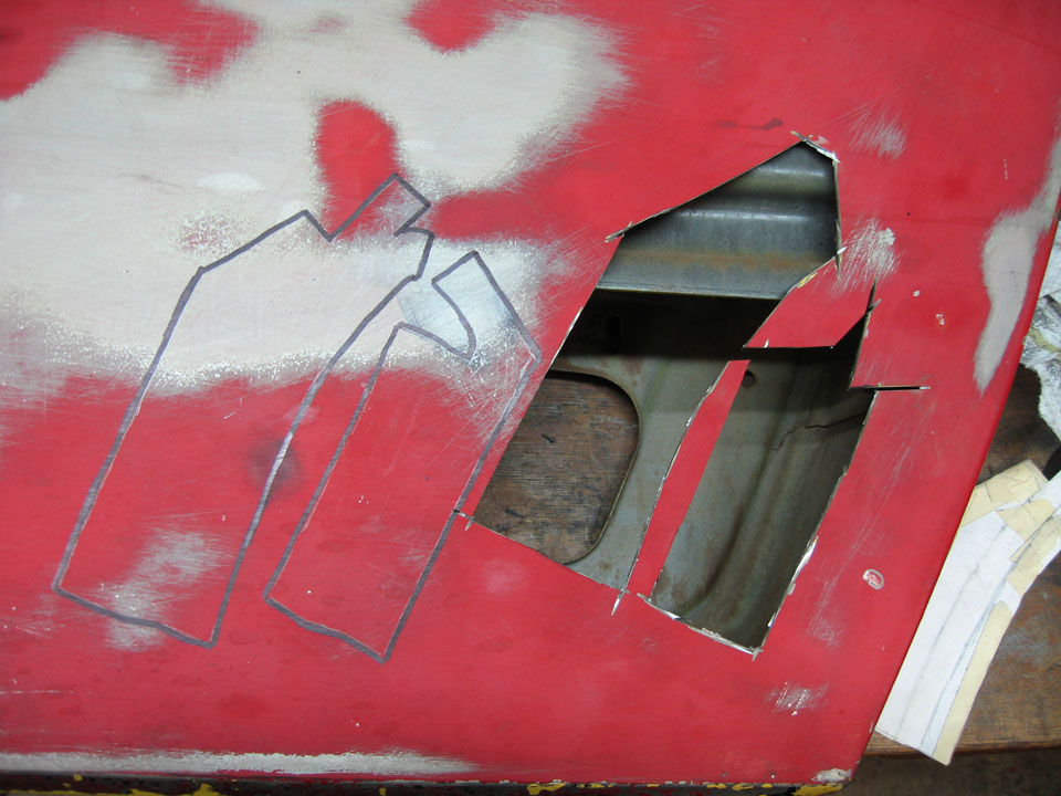

Another story is about how I have 3 driver doors and none of them will work for me. The original one, the skin is f'd. I got another one at a junk yard. Have I told this story? It ended up being a late door because I didn't know what to look for. I decided against using it for the various reasons, and I got another door. This kind guy, I think his name was Brett gave me (as well as the lower pdash pad previously mentioned) a perfect driver early door. Now the problem is that the bottom is out by an inch and a half when the top is about right, this at the back. I'm leaning toward removing the skin from the tweaked early door and putting it on my original door frame, though I haven't committed to that.
I've already removed the original door skin, but I'm saving it for part of the hellhole, so I've cut up the late door, too. Sorry if this peeves anyone. I was a bit leery of putting some crap metal home depot alloy steel in there, so ...
(IMG:http://www.914world.com/bbs2/uploads_offsite/www.914club.com-11782-1296535788.6.jpg)
Use of dirt to form a paper template
(IMG:http://www.914world.com/bbs2/uploads_offsite/www.914club.com-11782-1296535788.7.jpg)
A little foreshadowing
(IMG:http://www.914world.com/bbs2/uploads_offsite/www.914club.com-11782-1296535789.8.jpg)
I figured out on the 2nd attempt at this that chemical stripper will leave you with more metal than removing the paint with a wire wheel.
(IMG:http://www.914world.com/bbs2/uploads_offsite/www.914club.com-11782-1296535789.9.jpg)
Alas, it got a lot uglier before I abandoned it. (IMG:style_emoticons/default/sad.gif) I ended up grinding down that lump on the column part and going right through. It was too 'thin and thick' everywhere, and I decided to o it again. Took me all day and it's still not done.
The template for mk II involved masking tape, and I did the joint of the 2 pieces a bit better.

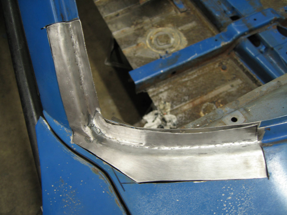

(IMG:http://www.914world.com/bbs2/uploads_offsite/www.914club.com-11782-1296535789.10.jpg)
A bit more to do. I'm waiting for my girlfriend (no longer ex - I got her back, the one from the dream (IMG:style_emoticons/default/smile.gif) ) to send me her drummel tool to more precisely take the welds in the nook down. Hopefully there will be no need for mkIII.
