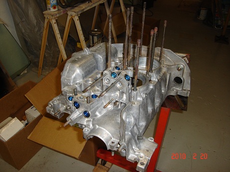

I found 12 in my 1.8/ '74 case. During rebuild, I tapped and plugged them, but it simply can't be done without dropping and dismantling the case. 2 or 3 are behind the flywheel. Look for the easy sources first. ScottD
