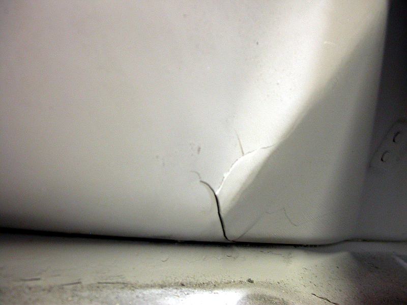

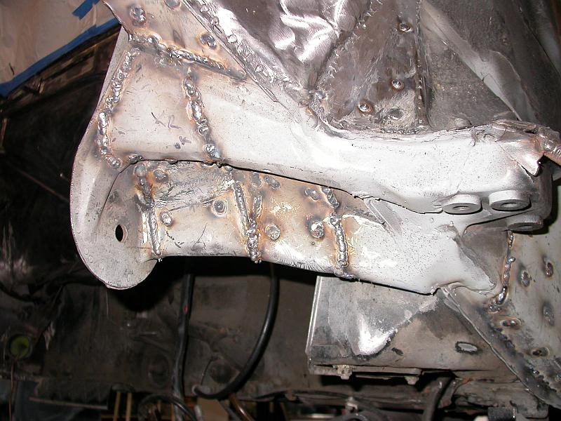

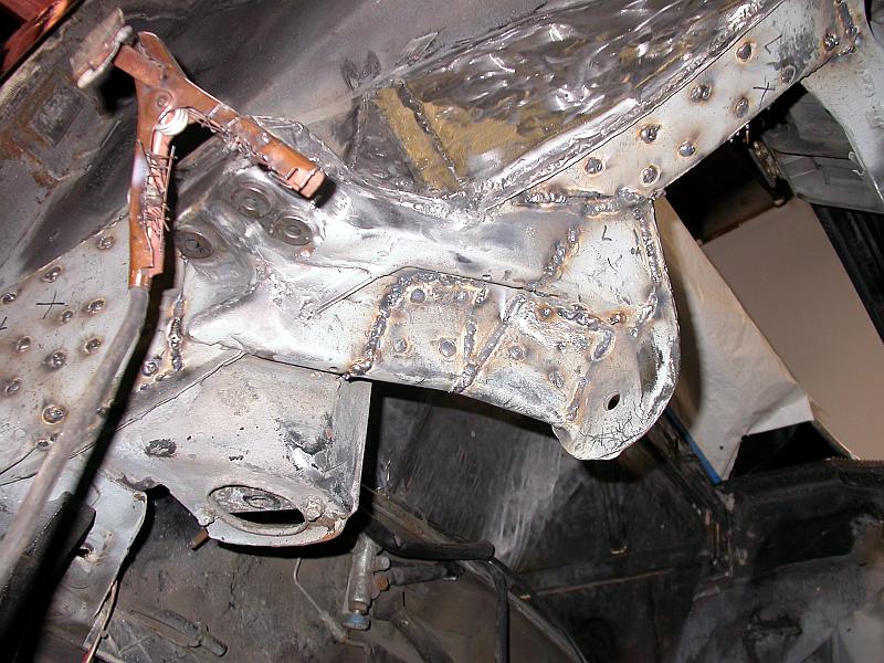

Some updates I got from Sean:
The usual crack in the long, crack travels 4-5 inches further underneath.
All welded up, engman kit installed.
Substantially reinforced RHS suspension ears.
Likewise for the LHS.
