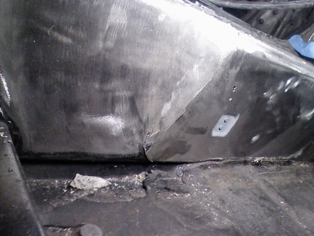

here's an ugly one. I cant find the pic from under teh floor. maybe on my cell phone...?

sean_v8_914   that stupid crack by the E brake made me chase it ...   Jan 25 2011, 08:21 AM

sean_v8_914   for some odd reason the chassis rail from teh rt s...   Jan 26 2011, 01:51 AM

karlo   Some updates I got from Sean: The usual crack in ...   Feb 5 2011, 09:59 PM
sean_v8_914   here's an ugly one. I cant find the pic from u...   Feb 6 2011, 12:07 PM
