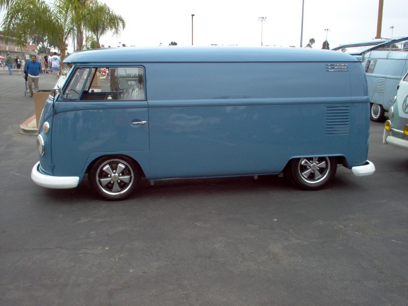

(IMG:style_emoticons/default/aktion035.gif) The more I think about it that blue would look pretty damn good on your car (IMG:style_emoticons/default/idea.gif)
Someone needs to photoshop that for you

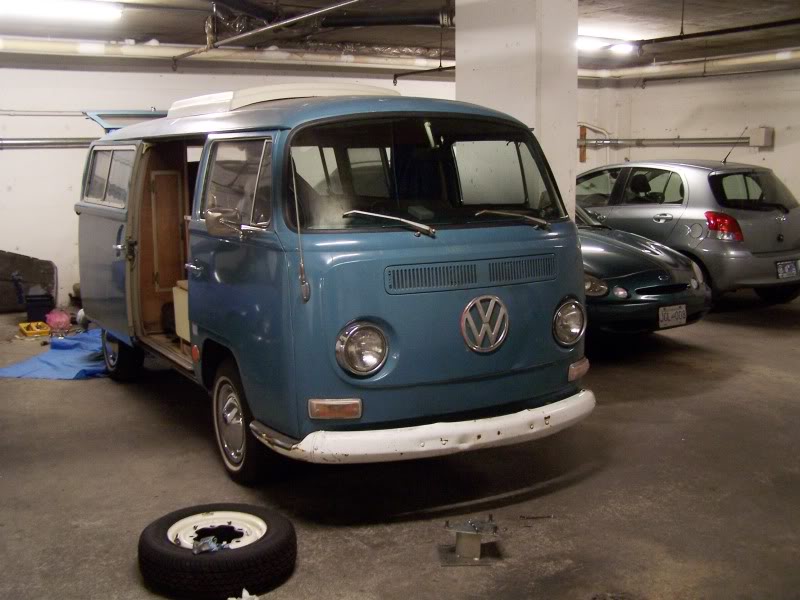

That color on the bus is dove blue (hovering over the image, the filename comes up confirming this (IMG:style_emoticons/default/smile.gif) ). The scion seems a bit more on the green side. It looks more along the lines of Neptune blue, which is more a 70's bay window color than the dove split color. They do look very much the same, Neptune is less saturated and more aqua.
(IMG:http://www.914world.com/bbs2/uploads_offsite/i141.photobucket.com-11782-1297273447.1.jpg)
edit, forgot to post the valuable link to the codes
http://www.thesamba.com/vw/archives/info/colorstype2.php
