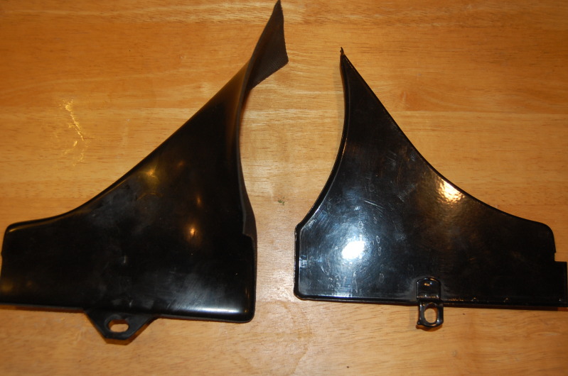

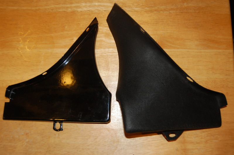

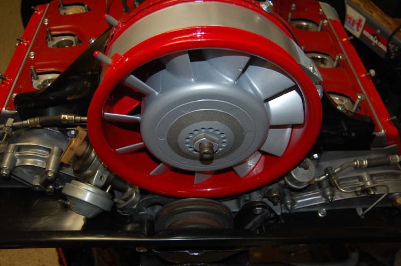

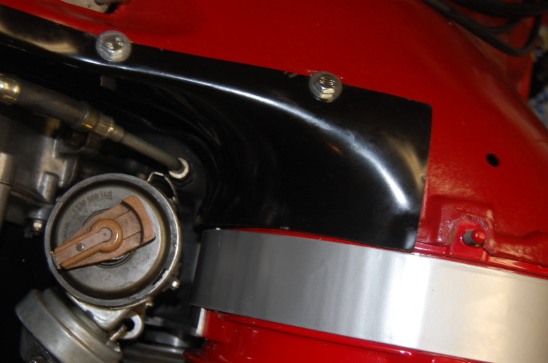

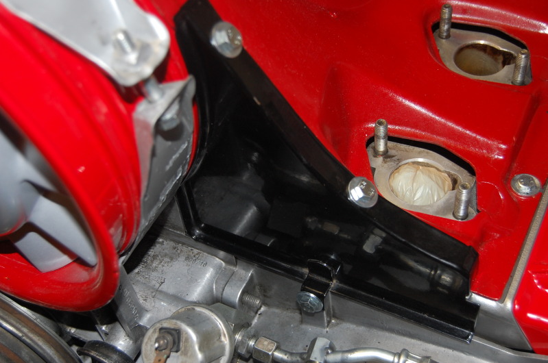

Look at what came in the mail today from Mark Epstien. Heater block off plates. I expected used up, beat up, oily, need painting tin. What arrived was practically new and so clean, so I just bolted them on. One is tin, the other is fiberglass. I think I will take them off and paint red to match the shroud. Thanks Mark. A pleasure doing business with you. Now as you can see, I need an alternator pulley half, nut, key, and shims. I'm almost ready to bolt the engine to the tranny.

moparrob   Looking good. Make sure you get the correct fan p...   Feb 10 2011, 11:11 PM
moparrob   by the way, what did you use on your fan strap to ...   Feb 10 2011, 11:12 PM
