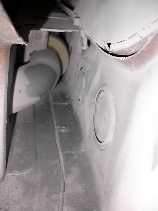

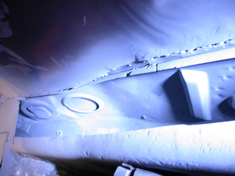

Acid etched, rust passivated, cold galvanized inside-out.
Treated all the way up using long wand adapter.

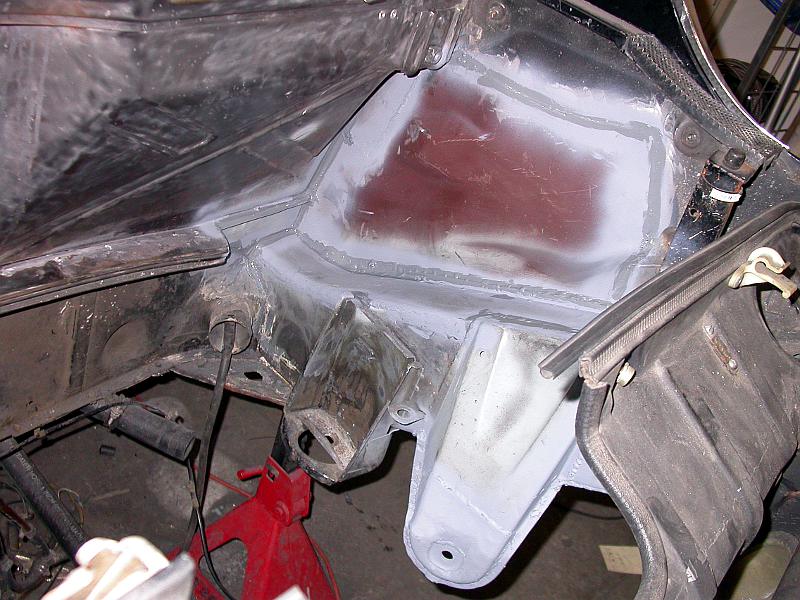

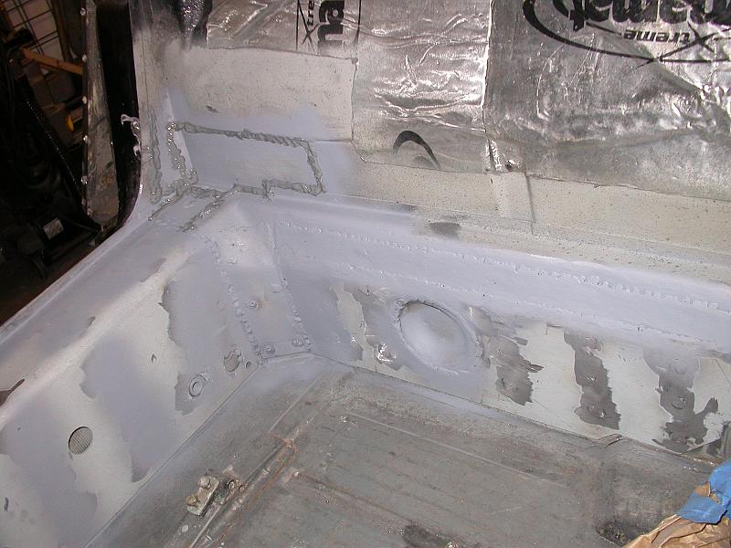

Etching primer, seam sealer, fresh metal.

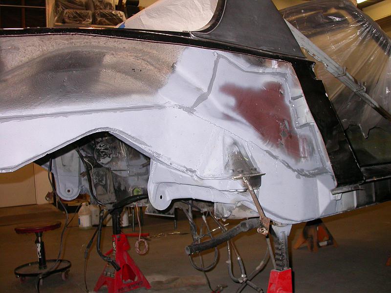

New inner wheel house. Metal replaced all the way up to the roll bar.

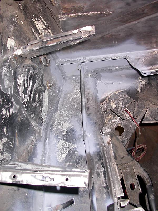

New cable pull.
Engman kit fitted and hole plugged.
