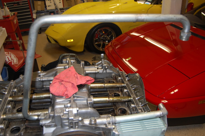

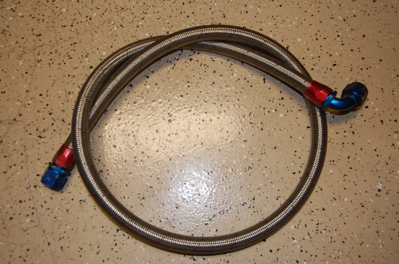

OK, I'm trying to figure out the oil lines. I assume that this long oil line
(IMG:http://www.914world.com/bbs2/uploads_offsite/i52.photobucket.com-3964-1297572148.1.jpg)
replaces this long hard oil line

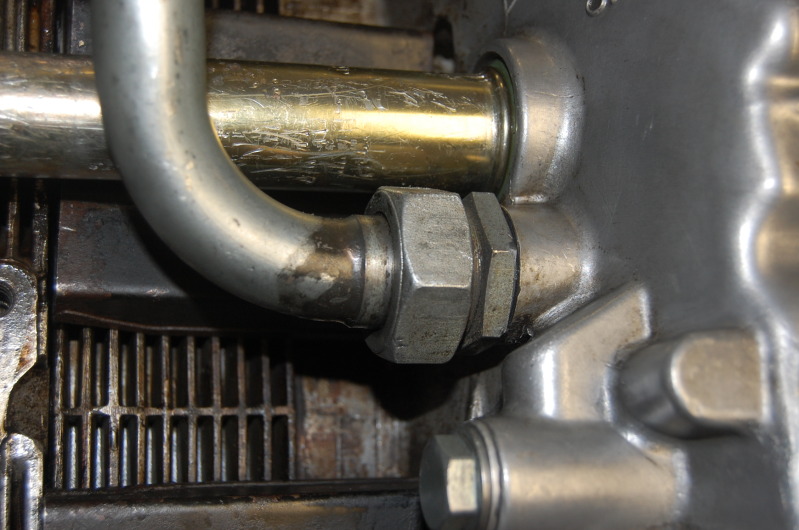

So, I need to remove this line and I can only get this much movement from the line and connecting nuts
(IMG:http://www.914world.com/bbs2/uploads_offsite/i52.photobucket.com-3964-1297572151.3.jpg)

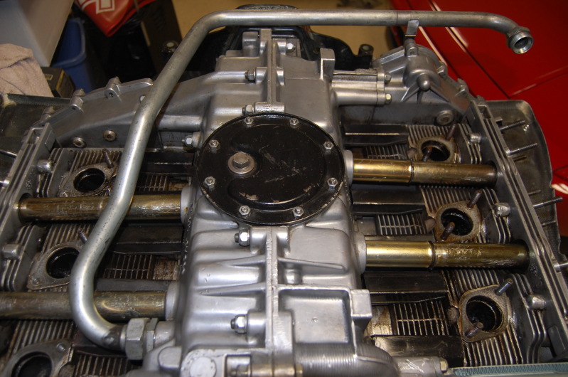

I can hack saw the hard line close to the nuts and get it off. But I just want to make sure, this long flex hose oil line plugs into here
(IMG:http://www.914world.com/bbs2/uploads_offsite/i52.photobucket.com-3964-1297572151.4.jpg)
on one end, and the side of the oil tank on the other end. I guess I need another adapter. What is the size of the metric connection into the bottom of the engine?

Bee Jay   OK, I'm trying to figure out the oil lines. I ...   Feb 12 2011, 10:42 PM
brp986s   If the 90 deg. end of your flex line will screw on...   Feb 12 2011, 11:56 PM
mepstein   Here's a 914-6 oil line and a 911 line that wa...   Feb 13 2011, 07:20 AM
9146986   Cut the hard line and silver solder or braze a AN ...   Feb 13 2011, 10:44 AM
dion9146   Another option is to put a metric to AN adapter r...   Feb 22 2011, 10:08 AM
Bee Jay   Ok, I figured it out. First, I found this fitting ...   Feb 13 2011, 08:40 PM
