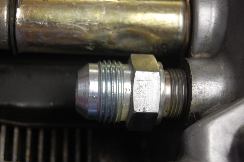

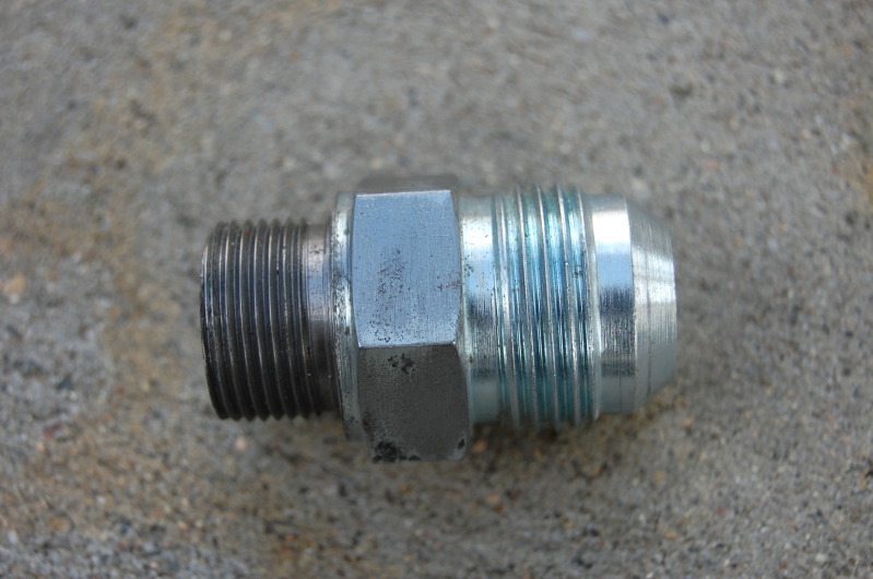

Ok, I figured it out. First, I found this fitting at the bottom of my oil tank and lines box.
(IMG:http://www.914world.com/bbs2/uploads_offsite/i52.photobucket.com-3964-1297651210.1.jpg)
Then using a very large adjustable cresent wrench I got the hard line out.
(IMG:http://www.914world.com/bbs2/uploads_offsite/i52.photobucket.com-3964-1297651210.2.jpg)

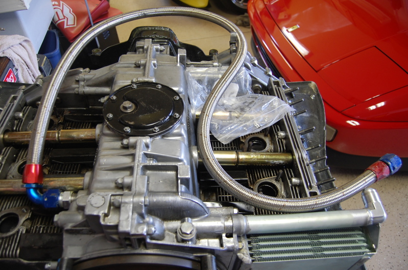

The fitting goes into the side of the engine, and the oil line attaches. The other end of this line will go to the oil tank for now, but toward RX-7 oil cooler in the nose of the car after I get things working.

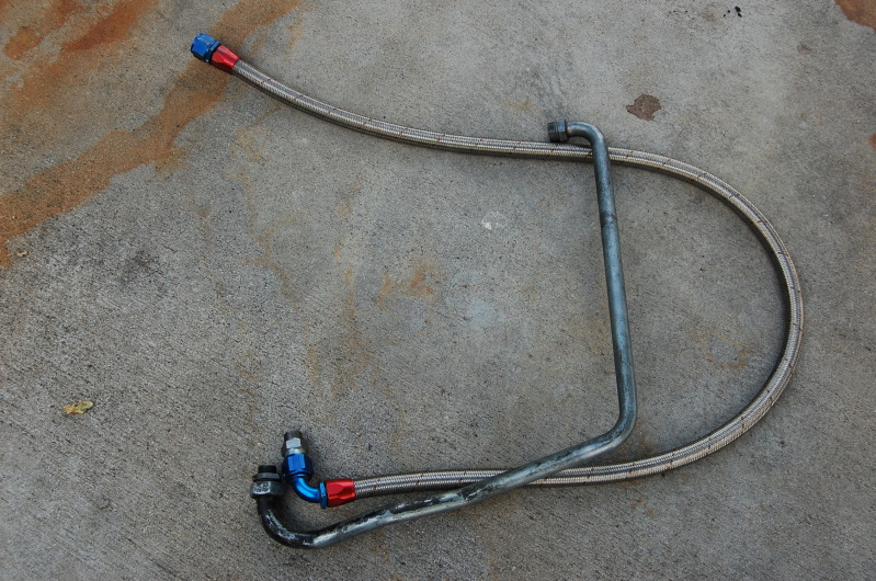

Bee Jay   OK, I'm trying to figure out the oil lines. I ...   Feb 12 2011, 10:42 PM
brp986s   If the 90 deg. end of your flex line will screw on...   Feb 12 2011, 11:56 PM
mepstein   Here's a 914-6 oil line and a 911 line that wa...   Feb 13 2011, 07:20 AM
9146986   Cut the hard line and silver solder or braze a AN ...   Feb 13 2011, 10:44 AM
