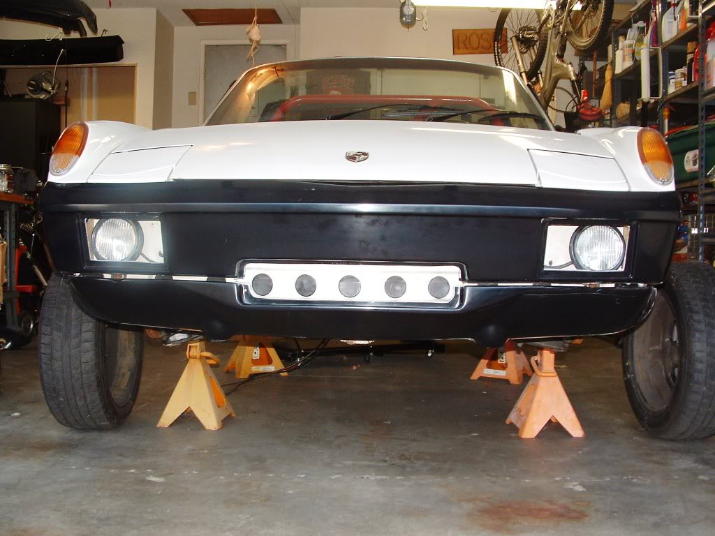

EXACTLY! That was what I was stressing about. Neither one seemed to be a good solution, so I agree with the idea of selling (or trading) the tank to someone who needs it. I'll probably have it hot tanked to remove the paint, then paint or powdercoat it before I sell it. I'm sure someone will appreciate it. I have no problem using an aftermarket tank - hell, most of my car will be aftermarket when I get through with it.
No offense taken, I'm just a bit frustrated by my lack of knowledge and I think having my car up on jack stands for 8 months is starting to get to me.
(IMG:http://www.914world.com/bbs2/uploads_offsite/i954.photobucket.com-11663-1298008368.1.jpg)
