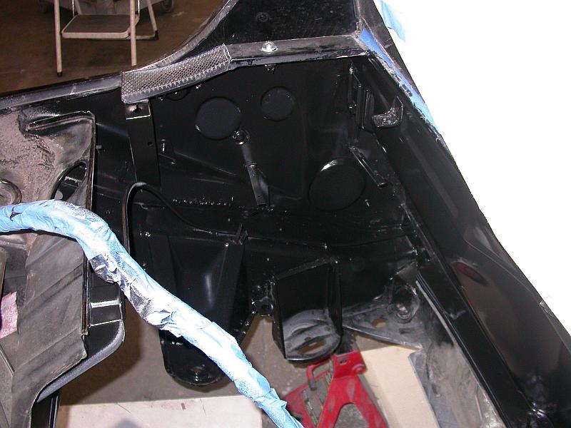

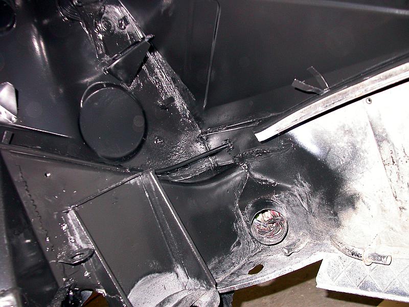

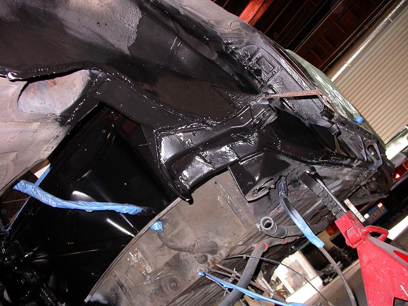

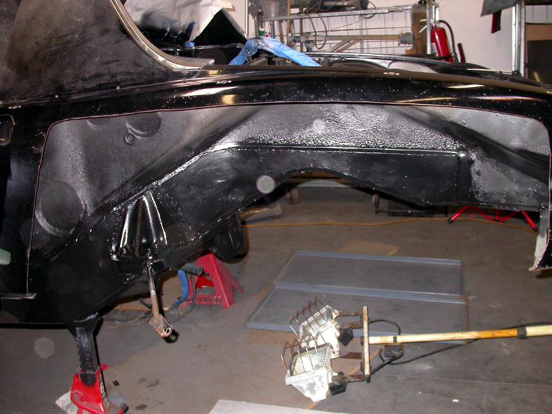

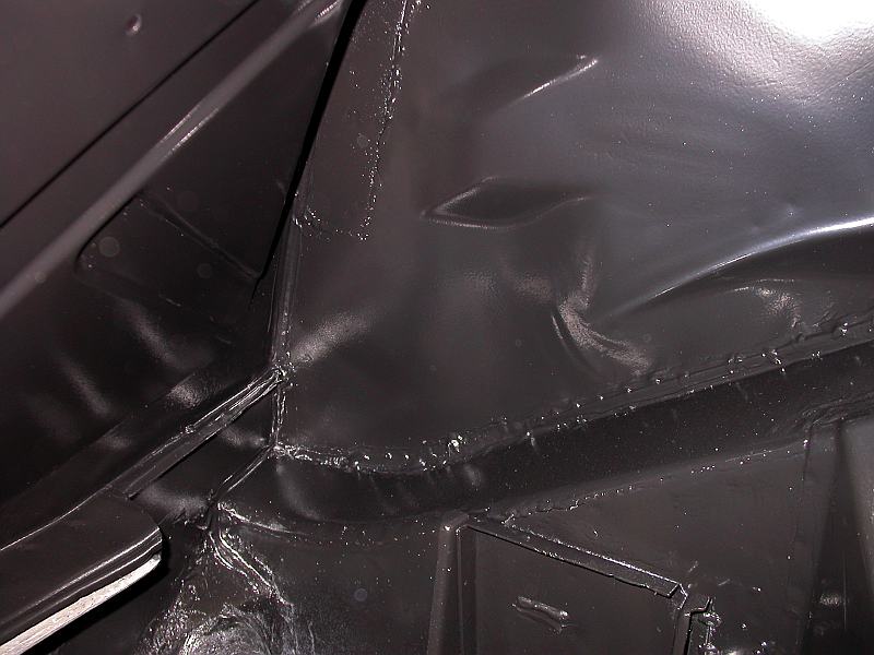

More updates from Sean:
Stealth GT.
Too dark to get good pics.
GT wraps around the long, not just a scab plate.
Left hell hole nice and cleaned up.
Image shows seam of inner wheel house. New inner wheel house panel runs from bottom of sail panel/roll bar doubler to the top of the longitudinal inner doubler. It is welded to the inside longitudinal stiffener. Then top longitudinal inner doubler welded to it, then top longitudinal cover welded over that and joined to the inner wheel house vertical wall. Yeah, it’s a little over-kill perhaps. All seams are sealed and prior to welding all joints treated with zinc weld thru.
