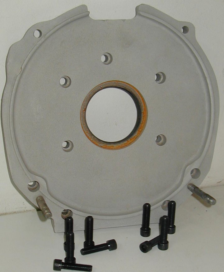

The corvair engine rotates opposite of most engines. This is a problem when one is interested in mating it to a different drive train. The prevalence of these engines in swaps using such drive trains allows for the ease of finding the parts to reverse the rotation of them. All that is needed is a cam and reverse dizzy gears.
Here is a link to Clark's Corvair site and the kit.
Current list price for a reverse cam (comes in several grinds) and dizzy gears:
Cam - $261 (up since when I bought mine)
Gears - $182 (Was $90 when I got mine)
I did not use my reverse parts as I ended up using a corvair powerglide auto tranz. Also, Clark's is only one vendor. There are many and most under cut Clark's significantly.
The part to mate your VW/Porsche tranz to a corvair engine is not usually hard to find either.
