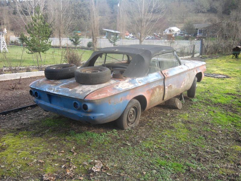

Sooo, then is this 63 convertable with no engine or tranny worth anything?

Lou W   Sooo, then is this 63 convertable with no engine o...   Feb 20 2011, 12:25 AM
silver74insocal   yep worthless..give me 50 bucks and i will haul it...   Feb 20 2011, 12:36 AM
