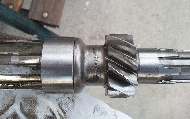

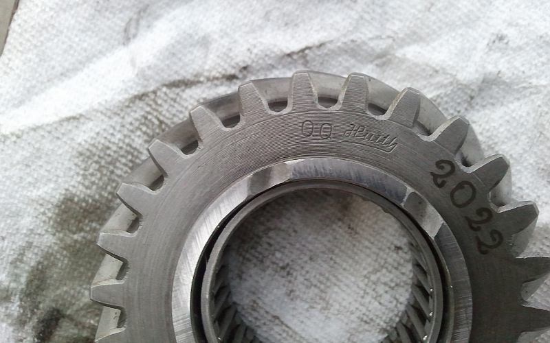

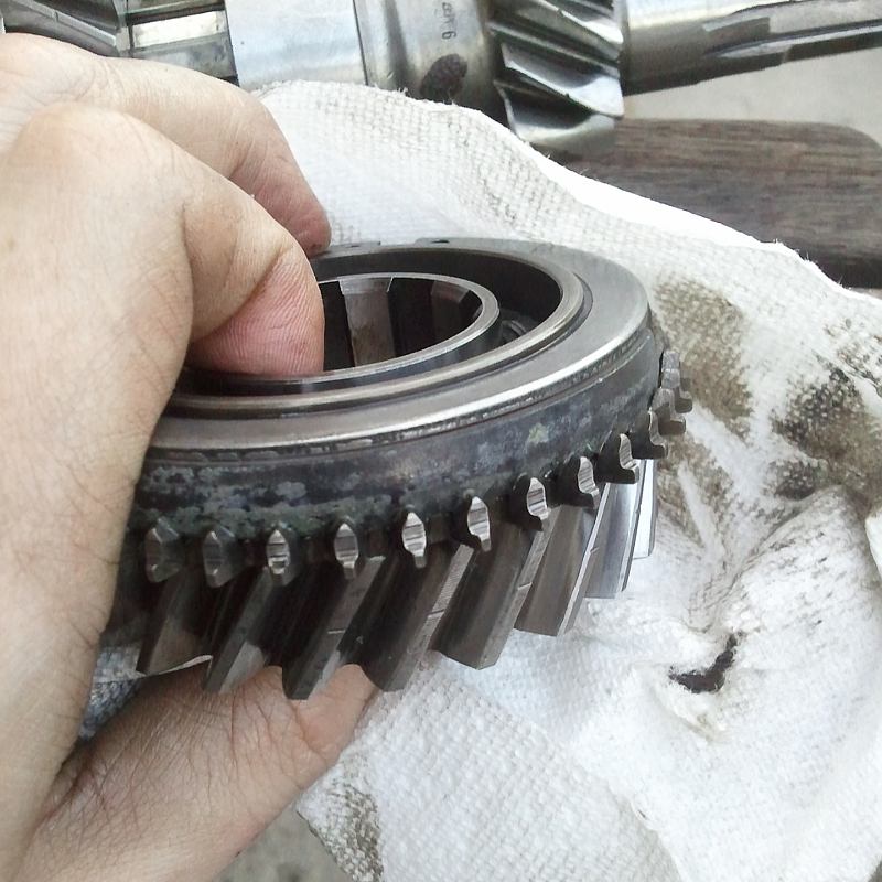

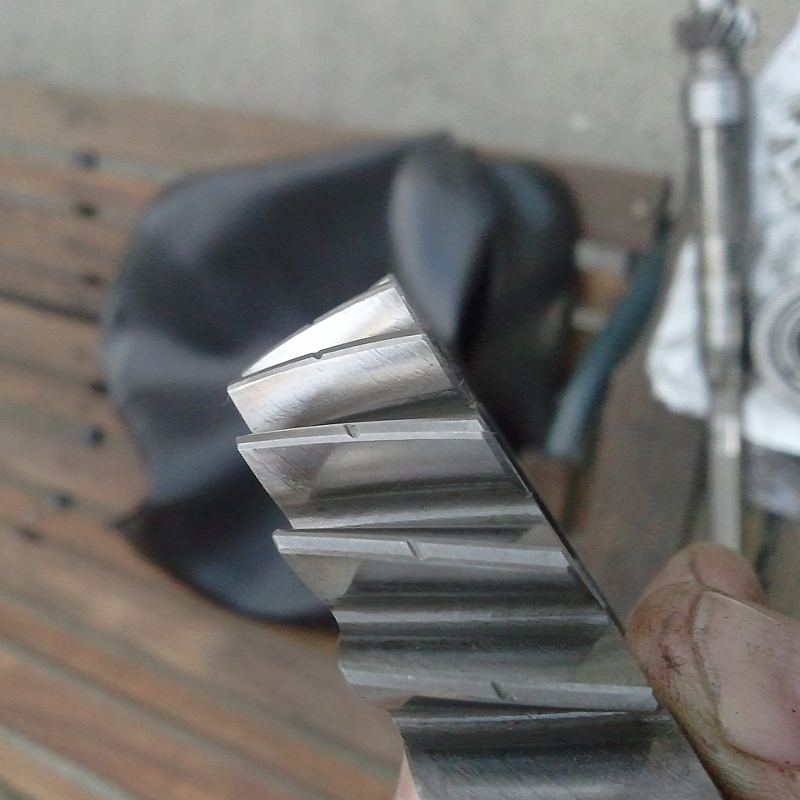

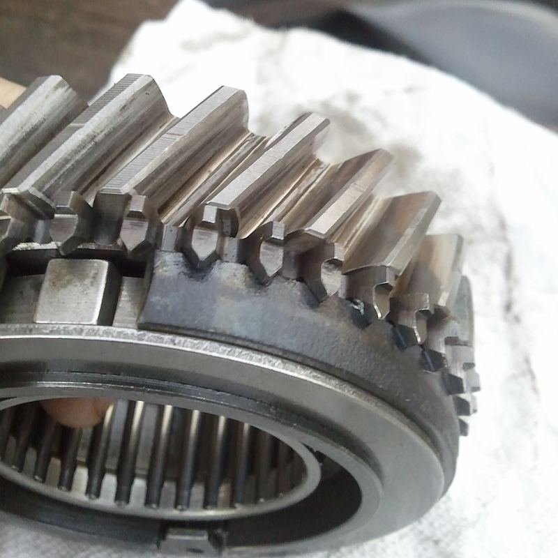

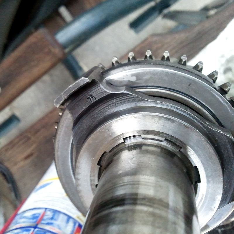

For documentational purposes, I'll include a few pictures from my transaxle overhaul.
New main shaft/1st gear (the strongest type).
Excellent new 2nd gear.
New 3rd gear, dog teeth and synchro.
Late fat synchro hub (previous was skinny, NLA).
QQ 4th gear.
And again, new dog teeth and synchro on 4th.
