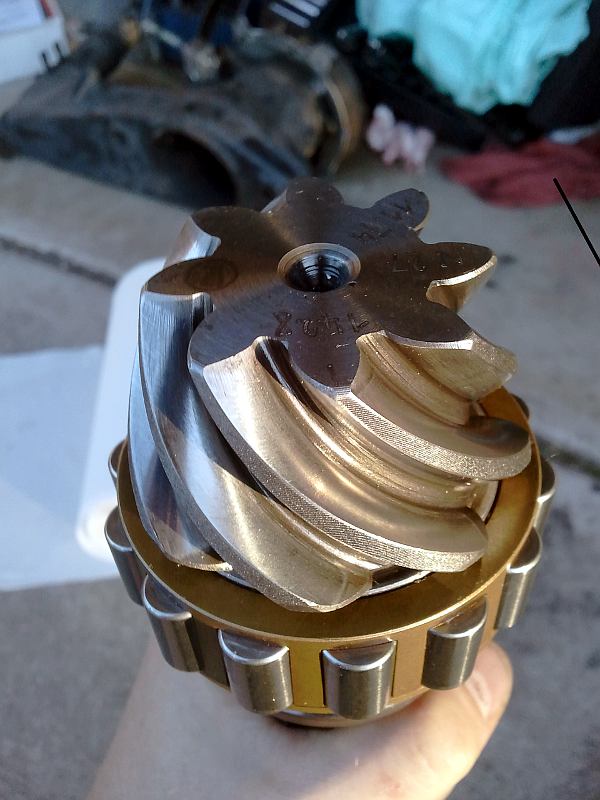

The ring and pinion was in excellent shape, so was reused.

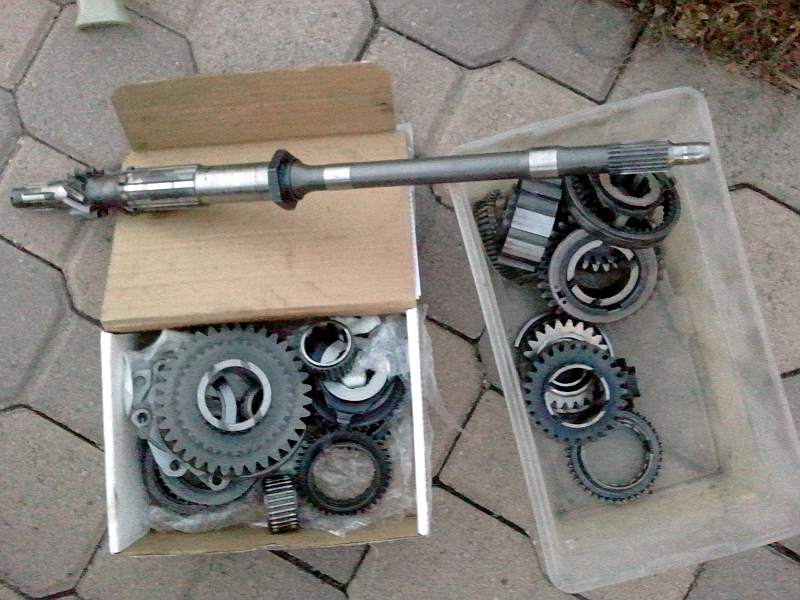

Finally, all the parts that got replaced... Lotsa dollars went into this.
