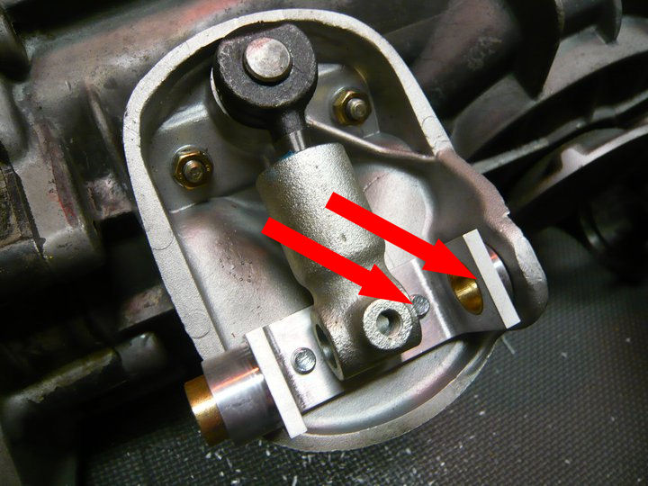

With the car off and the rear lifted for access, select 2nd gear and have someone put light pressure against the shifter to maintain full engagement. Check that the linkage is not bottoming out at the shift console at the transmission (this should have been checked at installation if following the instructions).
Back the shifter stops way off. You should have plenty of throw to bias the shifter to barely engage 3rd so you are sure to be fully engaging 2nd gear. If nothing is running out of throw on the linkage, then you have an internal problem.
The shifter and linkage do nothing to keep the gear engaged. They can prevent full engagement if something stops the throw before full engagement occurs. Note that the shifter stops are to be adjusted to provide clearance on full enagement and are only used in an overtravel condition.
Can you explain in a bit more details what you mean by this, not sure I follow you. Maybe a picture or 2 to point me in the right direction.

Just make sure that the linkage has some extra room to move when 2nd is engaged. You should not narrow it down to one place to look - you should check the whole system while you are at it since there is not much to it.
Here is a pic (thanks Eric) of the point that must be checked during assembly (both front and rear):

Sorted (IMG:style_emoticons/default/beerchug.gif)
I indeed had to move that aluminium piece (with the bronze bushings) above to the left by a few mm to allow 2nd gear to full engage. Thanks
