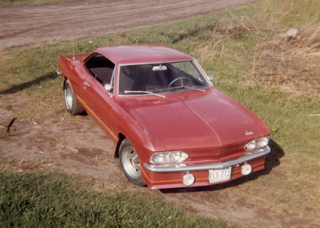

I can't find the resource infomation but I remember reading that the Corvair engine was originally designed for a tank project.
I have owned 5 corvairs a extremely low mileage 61 fawn beige auto coupe, a 62 white auto 4 dr, a 63 red 4 sp vert and a 65 4 sp coupe. as well as a cherry Greenbriar Van. The only photo I have is of my 65 coupe. The worse thing I ever had to fix were leaking push rod tubes. The smell of burning oil in the heaters were common.
This car was as bad as they get. Scraped down both sides, hit in the front, rusted out behind the rear wheels. I fab'd that air dam out of 18 ga. The paint is a custom mix laquer base red with wild rose pearl sprayed out over the base and the 8 coats of laquer clear cut and buffed. Oh, and this photo s probably close to 30 yrs old.
