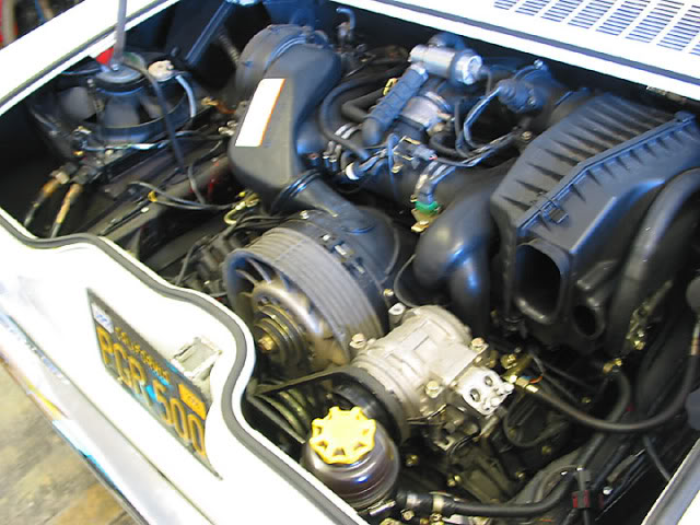

Here is a head with a stock plenum, modified with bungs for FI. This is a 140 head as it has two carb bases on it:
Standard engine:
