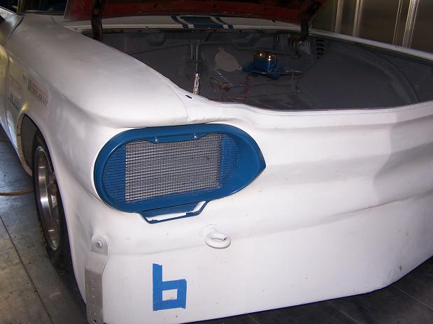

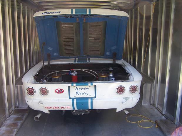

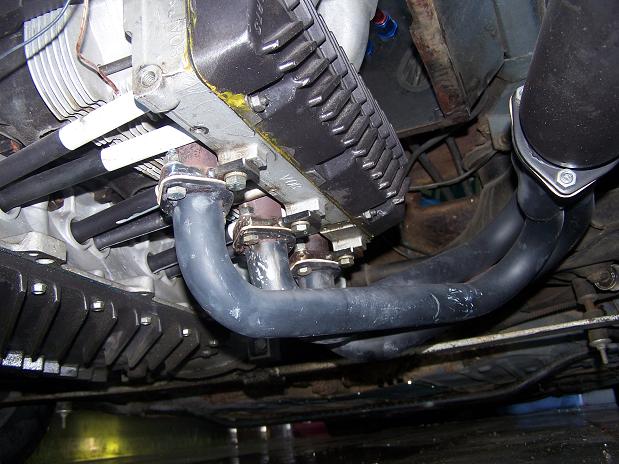

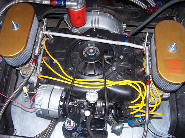

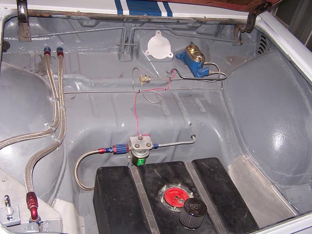

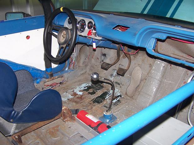

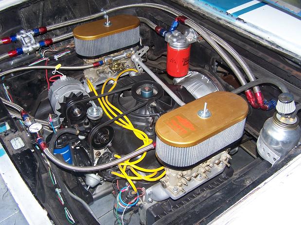

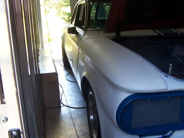

This is a friend's Corvair race car. The rear fender flares are off of one of the Chrysler K-cars. He's found that the front fenders have exactly the contour he wants not only for his Corvair but also for 914s.
The Corvair engine has been ported to accept the triple Webers as well as P/C and head work. The engine is immaculate and John estimates it puts out north of 250HP.
Brakes are still Corvair standard drum brakes.
