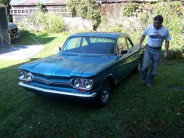

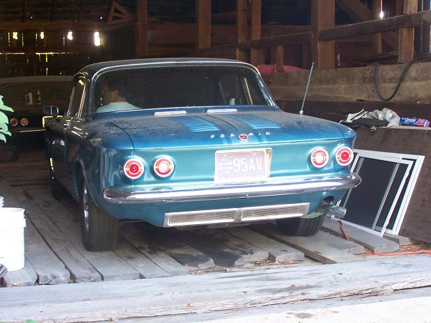

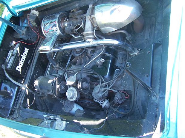

This is one nice Corvair. It has the 180HP turbo engine.

Spoke   This is one nice Corvair. It has the 180HP turbo e...   Feb 20 2011, 09:32 PM
