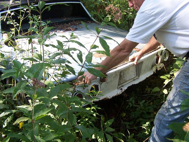

This one might end up being a 914vair. He plans to put Corvair rear panel, Corvair engine, and Chrysler K-car wheel flares that he found match the contour of the 914.
