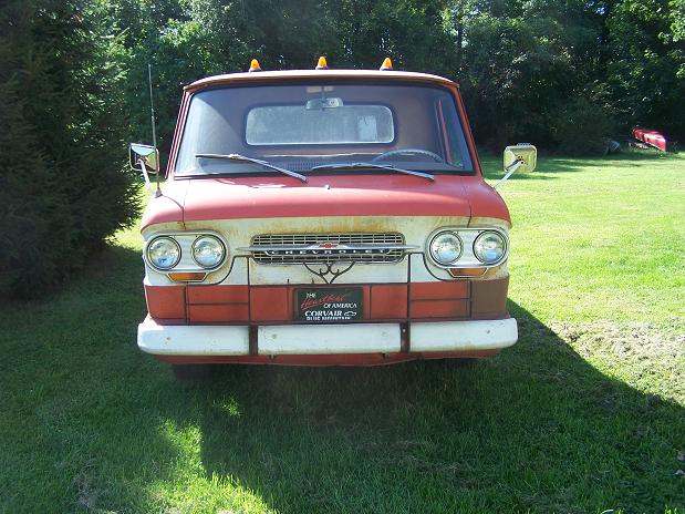

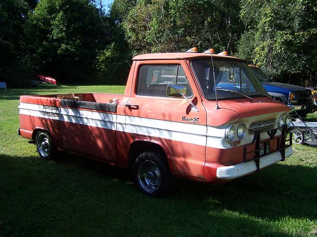

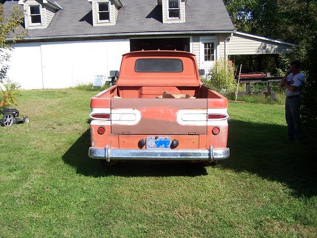

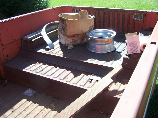

No Corvair collection is complete without a Corvair pickup.

Spoke   No Corvair collection is complete without a Corvai...   Feb 20 2011, 09:39 PM
