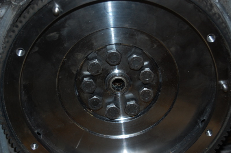

The Captain, John Larson, lent me the 12 point tool to get the bolts of the old flywheel off. After I got it off, I tried to test fit the Kennedy Engineering flywheel. Dang thing would not bolt up. After much head scratching, I figured it out. The flywheel will on bolt on one way, you have to rotate it untill all bolt holes line up. I never read that anywhere. But now I know.
Bee Jay
(IMG:http://www.914world.com/bbs2/uploads_offsite/i52.photobucket.com-3964-1298525135.1.jpg)
