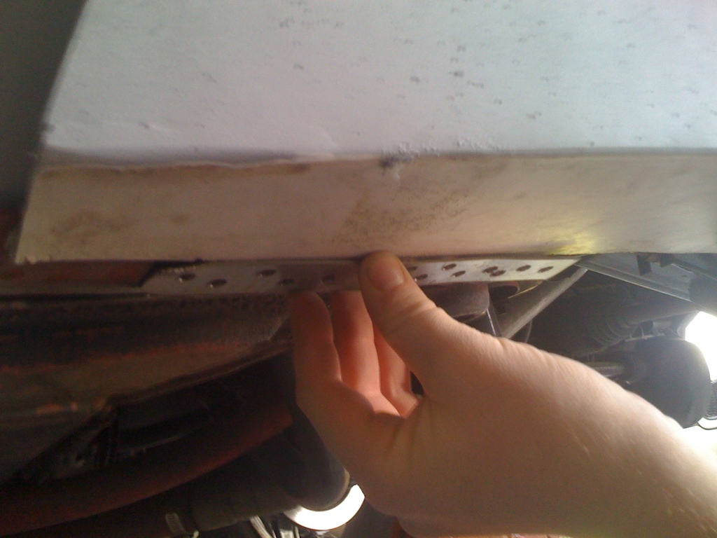

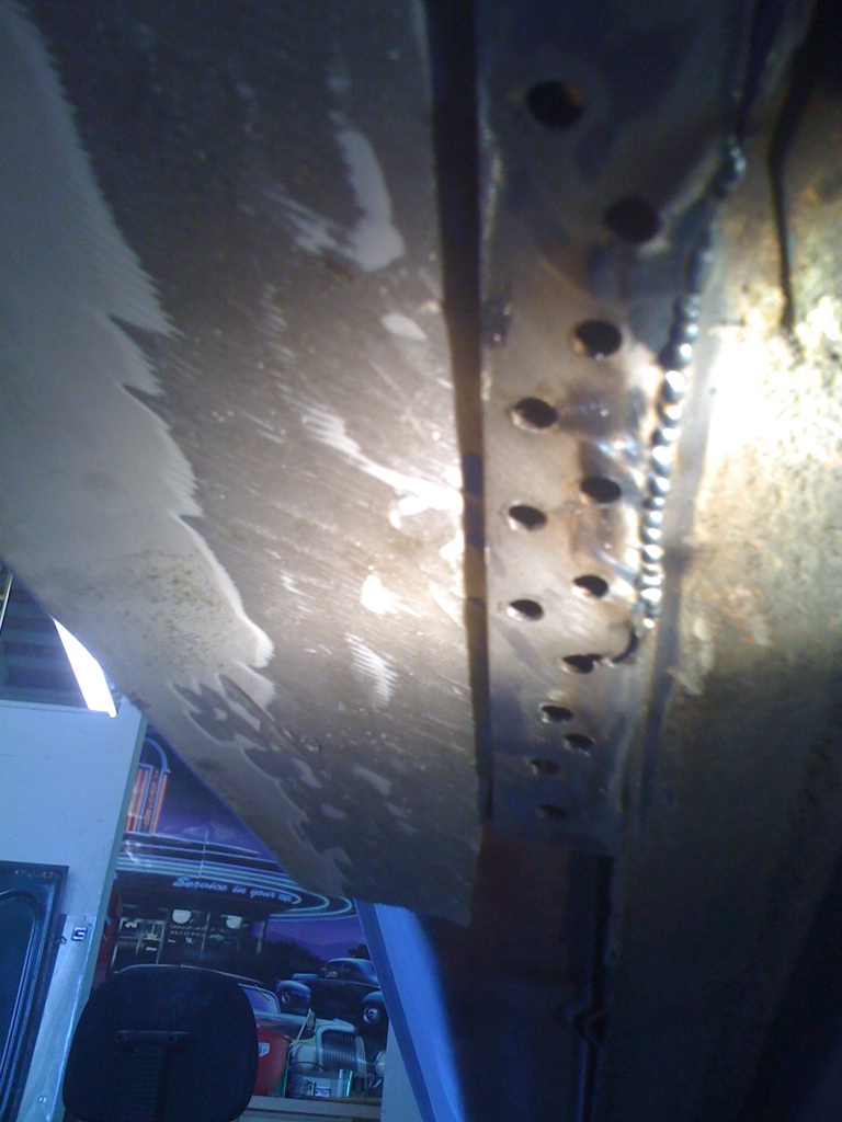

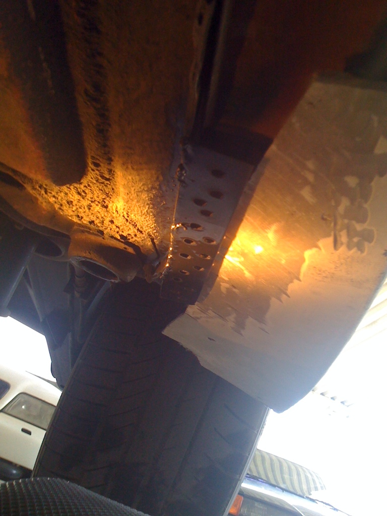

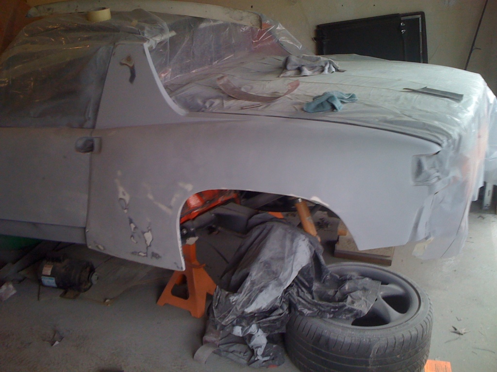

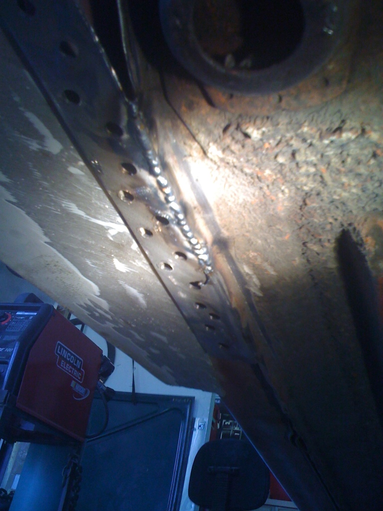

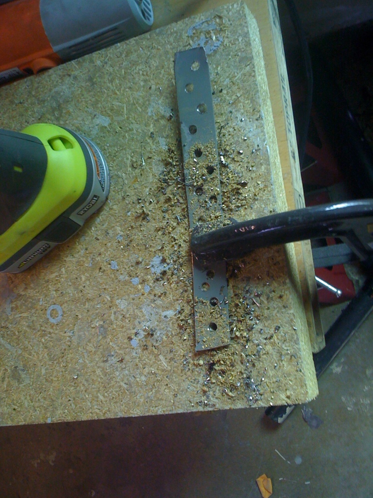

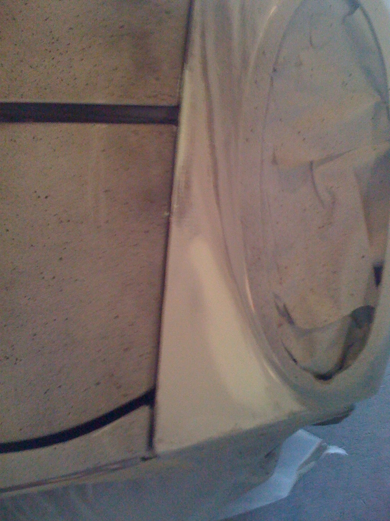

Cut and drilled the extension I need to reinforce the fenders.
(IMG:http://www.914world.com/bbs2/uploads_offsite/i1210.photobucket.com-172-1298878381.3.jpg)
(IMG:http://www.914world.com/bbs2/uploads_offsite/i1210.photobucket.com-172-1298878382.4.jpg)
(IMG:http://www.914world.com/bbs2/uploads_offsite/i1210.photobucket.com-172-1298878382.5.jpg)
Extension welded and primed.
(IMG:http://www.914world.com/bbs2/uploads_offsite/i1210.photobucket.com-172-1298878382.6.jpg)
(IMG:http://www.914world.com/bbs2/uploads_offsite/i1210.photobucket.com-172-1298878383.7.jpg)

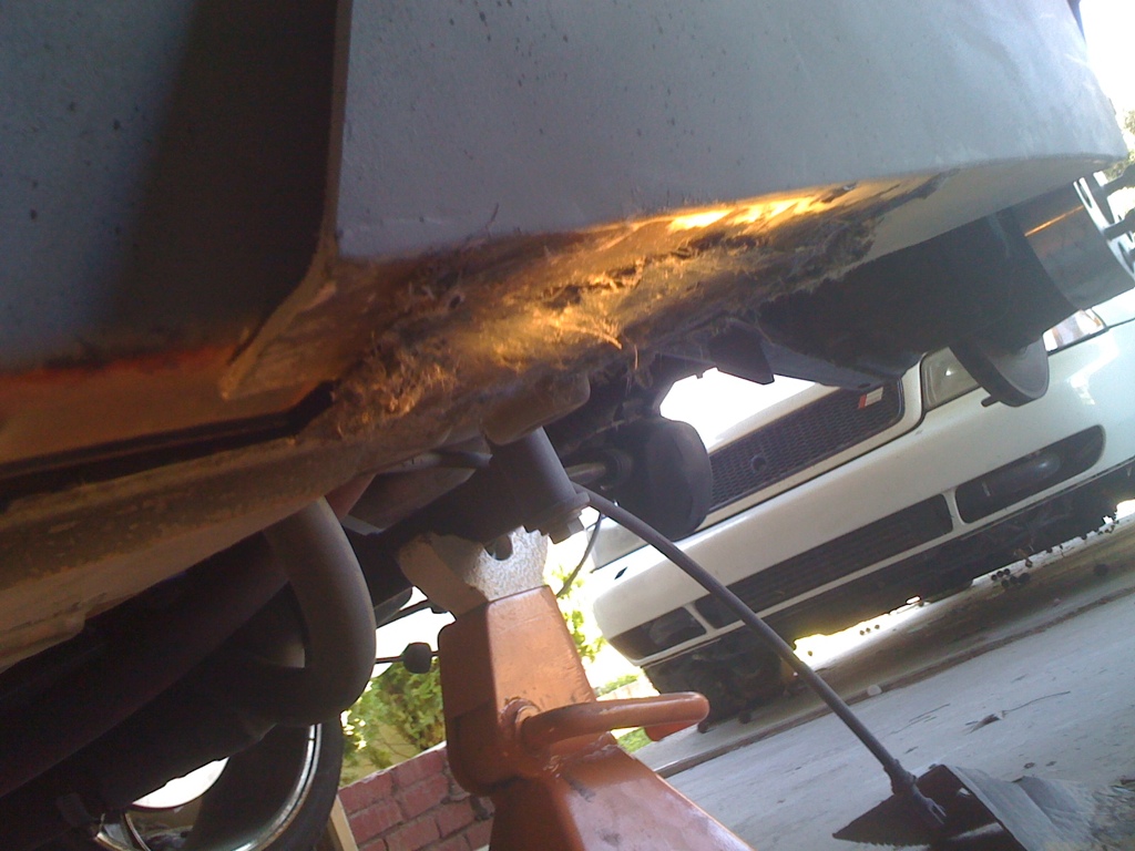

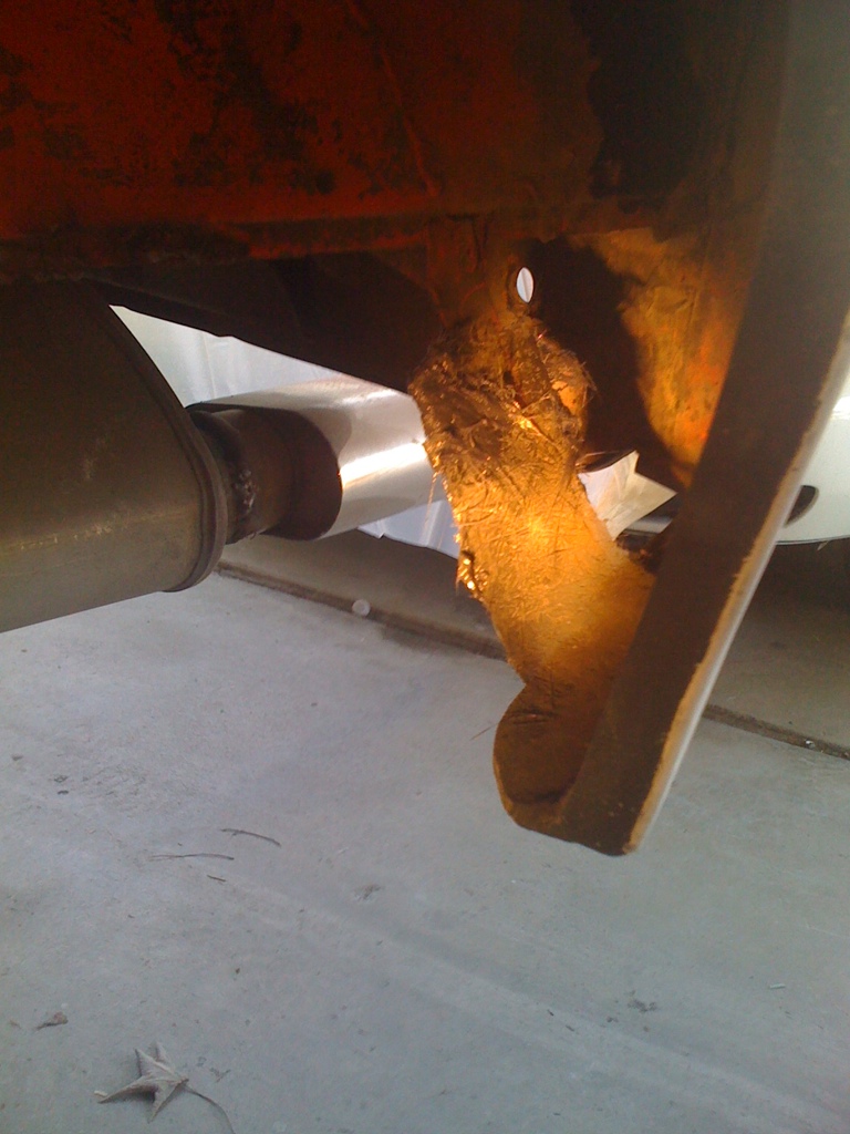

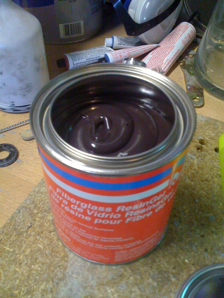

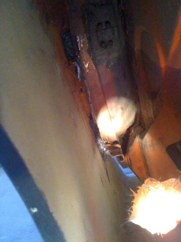

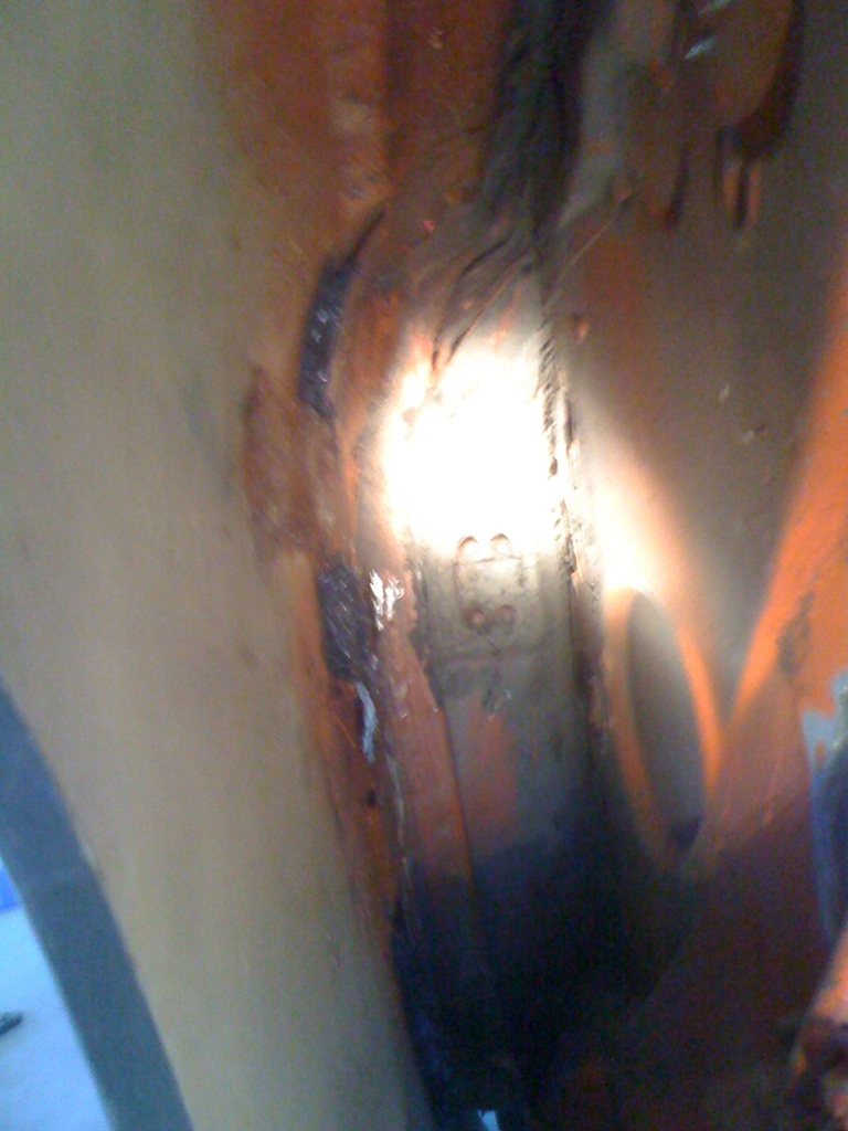

Instead of resin, I saw this stuff at the body shop and figured i'd give it a try. Supposed to be good for vertical stuff. Well it was impossible to "dip" the fiberglass in, so I literally had to add the fiberglass to the mix and stir it in and add it to the panel like kitty hair (or bondo with fiberglass). It also uses cream hardner. I wouldnt do it again, but it worked.
(IMG:http://www.914world.com/bbs2/uploads_offsite/i1210.photobucket.com-172-1298878383.8.jpg)
(IMG:http://www.914world.com/bbs2/uploads_offsite/i1210.photobucket.com-172-1298878383.9.jpg)
(IMG:http://www.914world.com/bbs2/uploads_offsite/i1210.photobucket.com-172-1298878384.10.jpg)
(IMG:http://www.914world.com/bbs2/uploads_offsite/i1210.photobucket.com-172-1298878384.11.jpg)
(IMG:http://www.914world.com/bbs2/uploads_offsite/i1210.photobucket.com-172-1298878384.12.jpg)

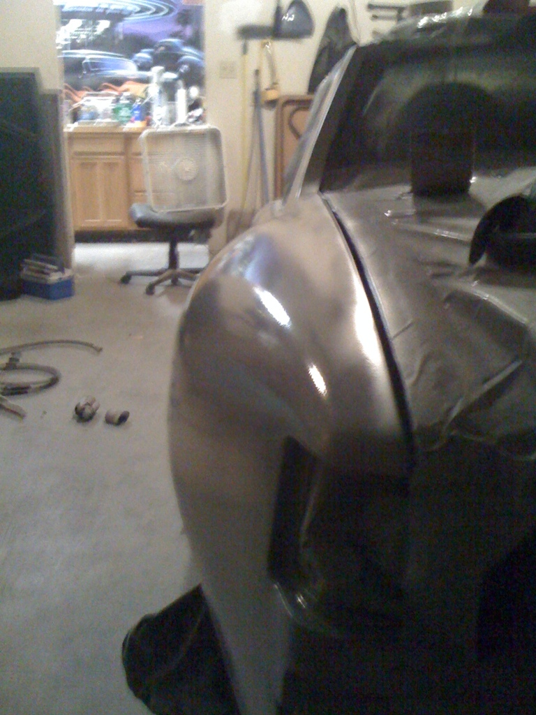

Reinforced some of the area's that I didnt do so well the first go around. The fender is VERY solid now.
(IMG:http://www.914world.com/bbs2/uploads_offsite/i1210.photobucket.com-172-1298878385.13.jpg)
(IMG:http://www.914world.com/bbs2/uploads_offsite/i1210.photobucket.com-172-1298878385.14.jpg)
(IMG:http://www.914world.com/bbs2/uploads_offsite/i1210.photobucket.com-172-1298878385.15.jpg)

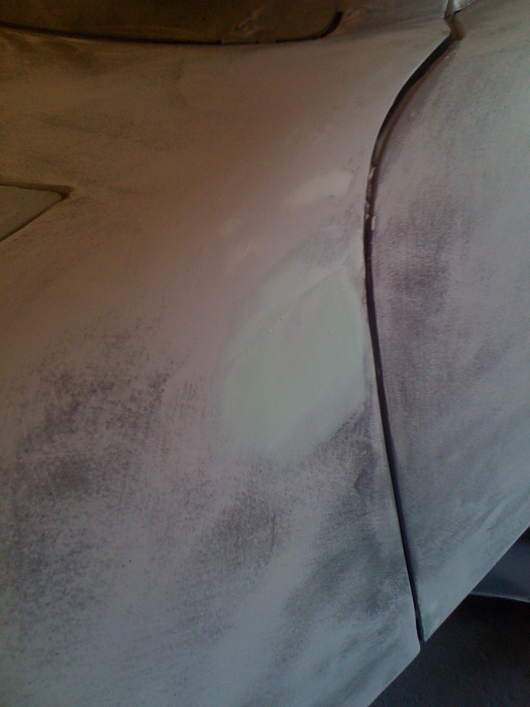

Just a couple of pictures, but there was a lot of pinholes that I filled.
(IMG:http://www.914world.com/bbs2/uploads_offsite/i1210.photobucket.com-172-1298878386.16.jpg)
(IMG:http://www.914world.com/bbs2/uploads_offsite/i1210.photobucket.com-172-1298878386.17.jpg)

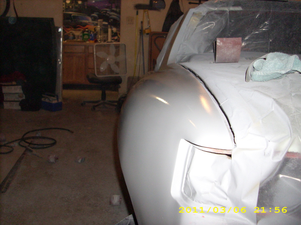

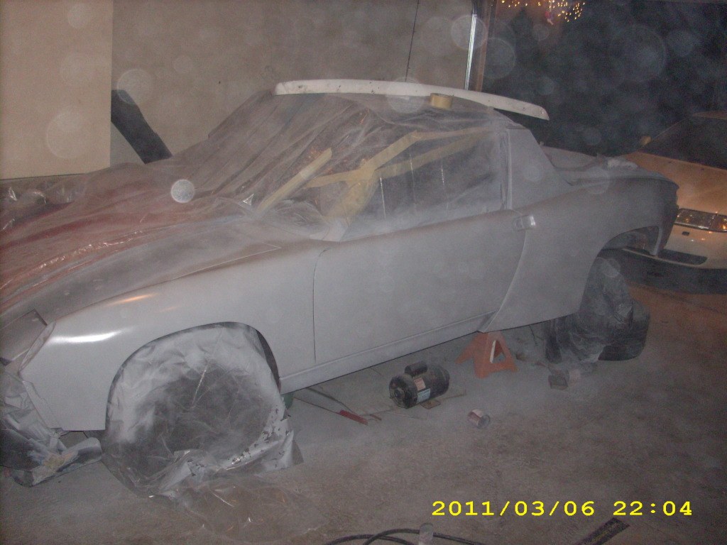

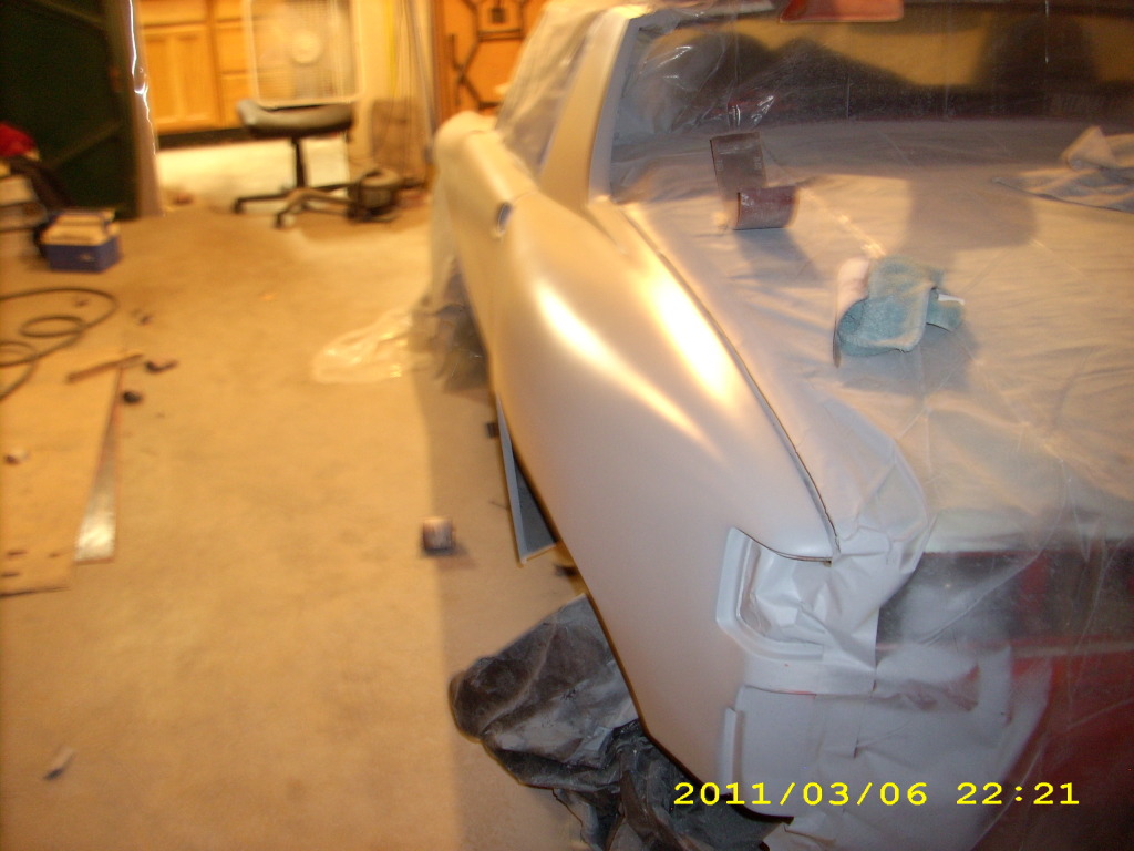

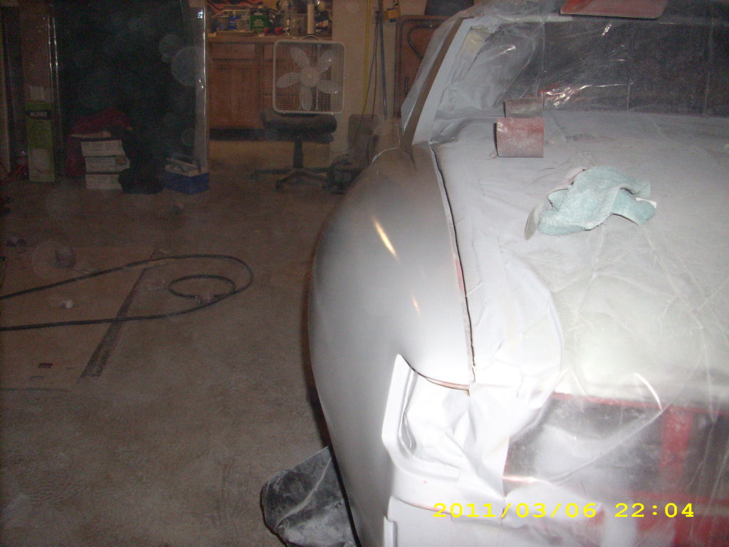

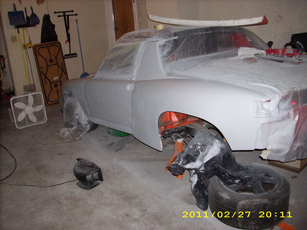

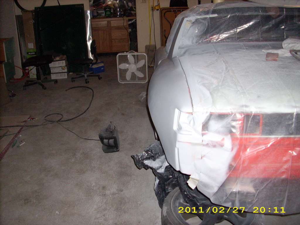

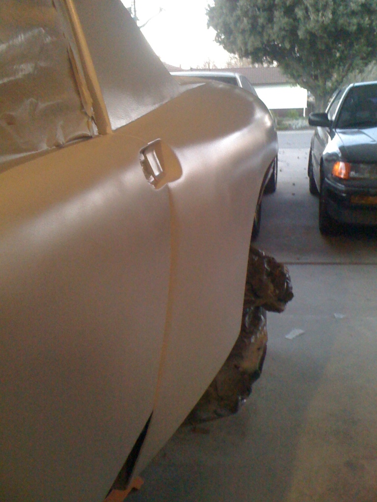

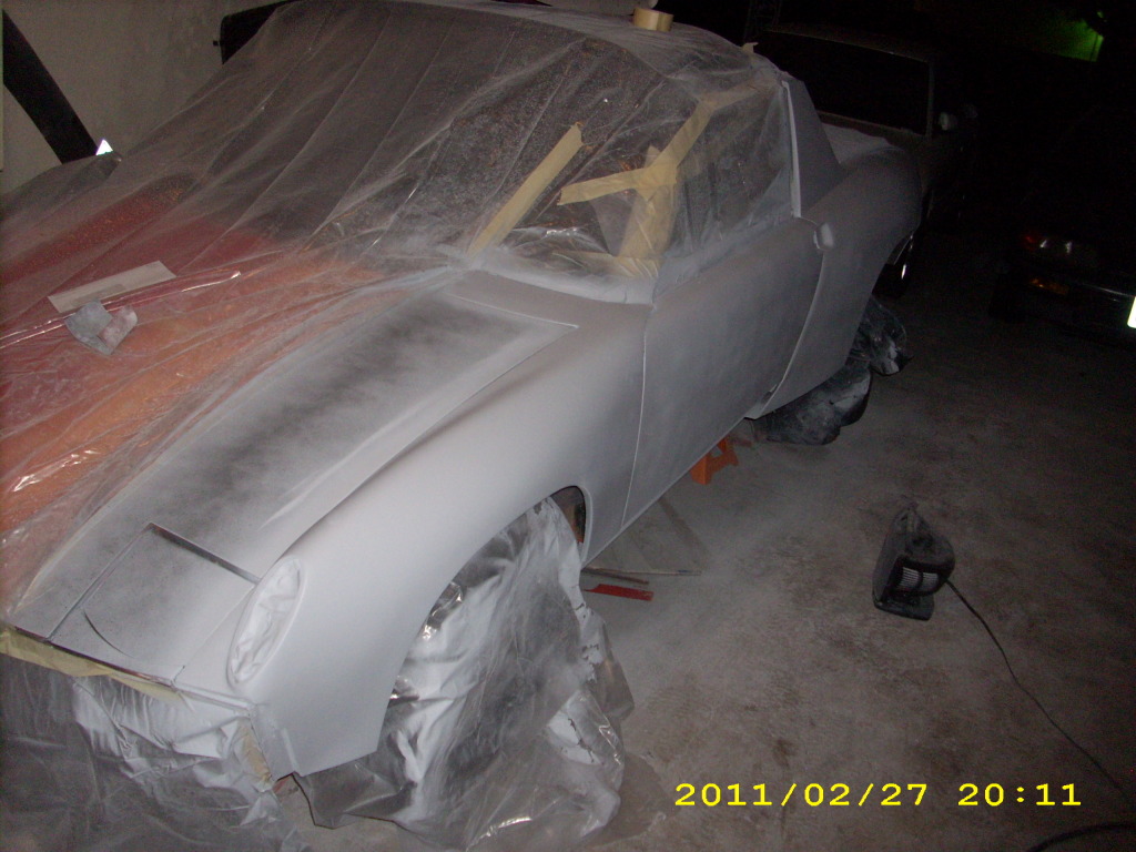

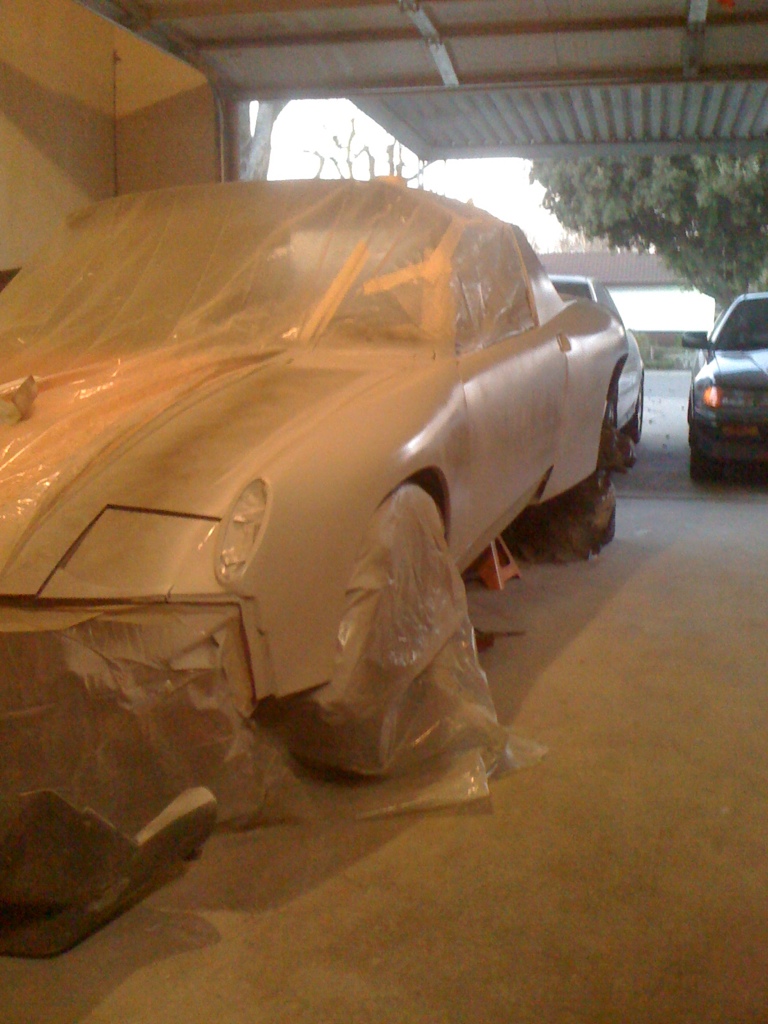

Guess what? More primer!! It looks SO good!
(IMG:http://www.914world.com/bbs2/uploads_offsite/i1210.photobucket.com-172-1298878386.18.jpg)
(IMG:http://www.914world.com/bbs2/uploads_offsite/i1210.photobucket.com-172-1298878387.19.jpg)
(IMG:http://www.914world.com/bbs2/uploads_offsite/i1210.photobucket.com-172-1298878387.20.jpg)
(IMG:http://www.914world.com/bbs2/uploads_offsite/i1210.photobucket.com-172-1298878388.21.jpg)
(IMG:http://www.914world.com/bbs2/uploads_offsite/i1210.photobucket.com-172-1298878388.22.jpg)
The primer doesnt come out of the gun very nicely, but this is my last bit of primer filler. My next layer of primer will be primer sealer and i'll reduce it a bit.
