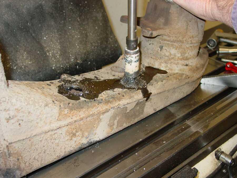

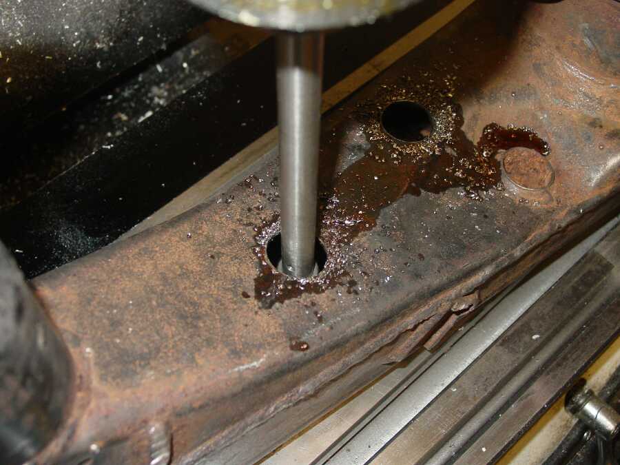

I did some work on the trailing arms a couple weeks ago, stole the idea from Eric.
Mark Kinnaman set the arm up in the mill and punched some 1 inch holes.

gms   I did some work on the trailing arms a couple week...   Feb 28 2011, 10:43 AM
gms   I found some 1" pipe at McMaster-Carr   Feb 28 2011, 10:46 AM
gms   insert in the holes, weld and there they are. I wi...   Feb 28 2011, 10:48 AM
