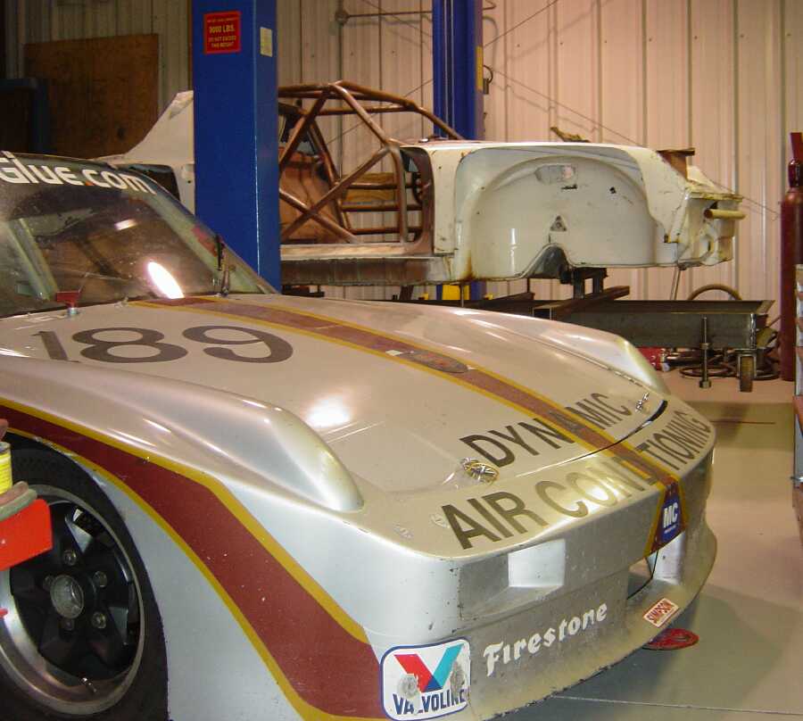

Back in November I finally started working on the car. Here is my other IMSA race car in the foreground and 0945 on the lift in Mark's shop.

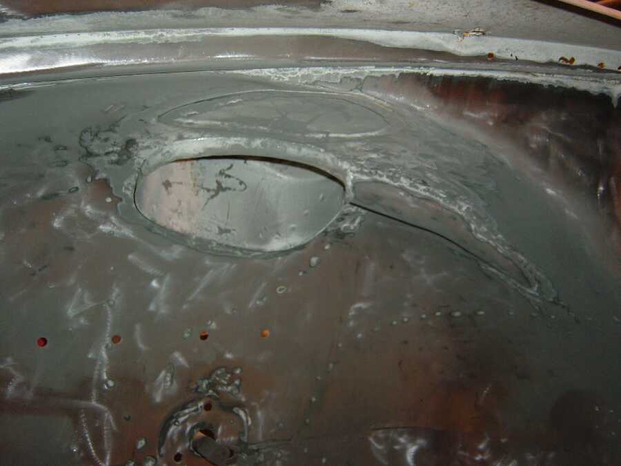

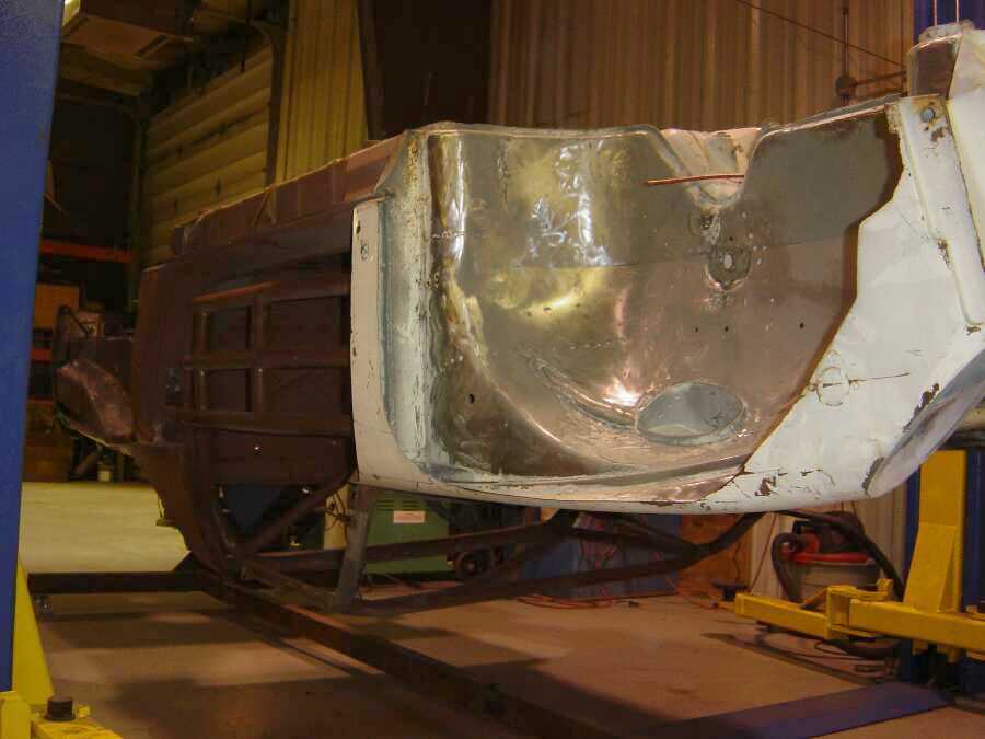

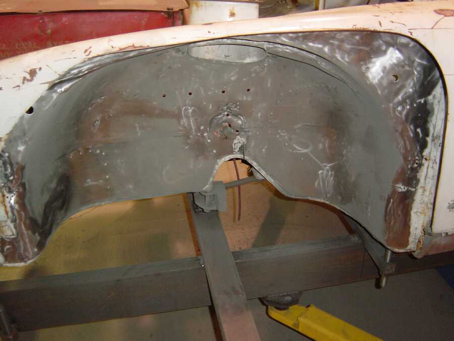

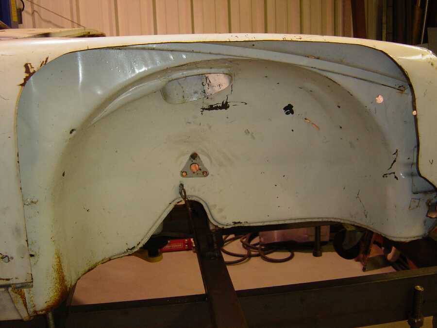

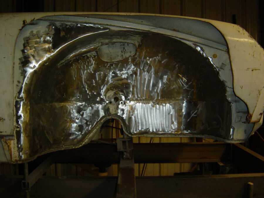

I started to strip the passenger front wheel haus and weld all the unnecessary holes (there are many)
Click to view attachmentClick to view attachment
J P Stein
Feb 13 2011, 06:21 PM
This worked best for me....if you're gonna hand strip.
"Rice cakes" (2-1/2 or 3 inch) and a 90deg die grinder.
Were I in your shoes with all the weird/tight spots, I'd consider media blasting that thing. I'm some what of a gluton for punishment but that's too much for me.
gms
Feb 13 2011, 08:39 PM
QUOTE(J P Stein @ Feb 13 2011, 06:21 PM)
I am using 3 inch 3M rolock sp?, they work well since i am welding as i go.
I still might get it blasted but as long as I am working in the area I manually strip it.

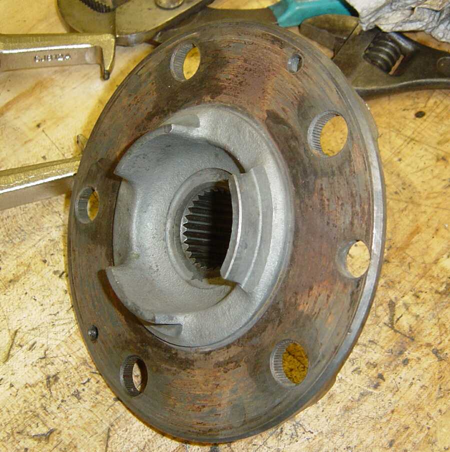

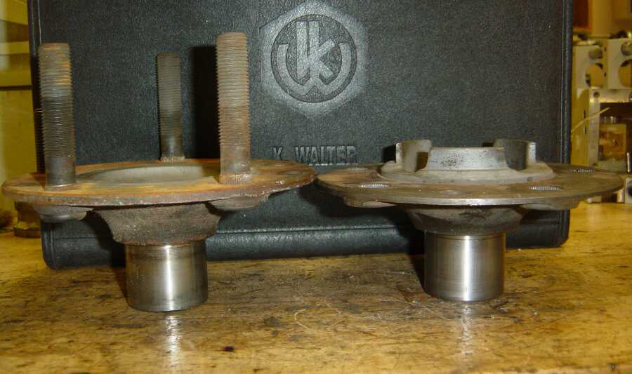

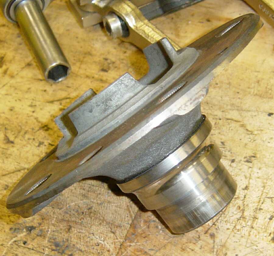

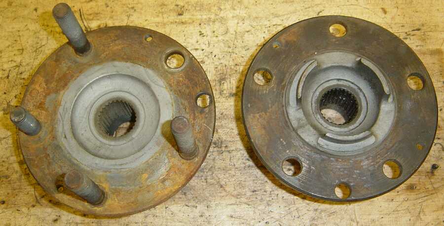

Mark cut down some 911 SC rear hubs to use in the race car
gms
Feb 15 2011, 08:57 PM
here is the original hub (L) and SC hub ® side by side

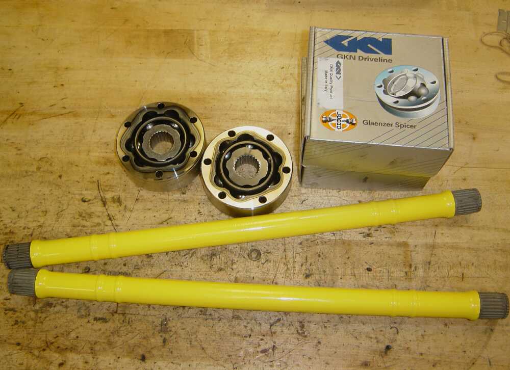

My powder coated 914/6 axles arrived today from Alan Gibson.
The 911 SC CV joints will be mounted after the axles are cut to fit.

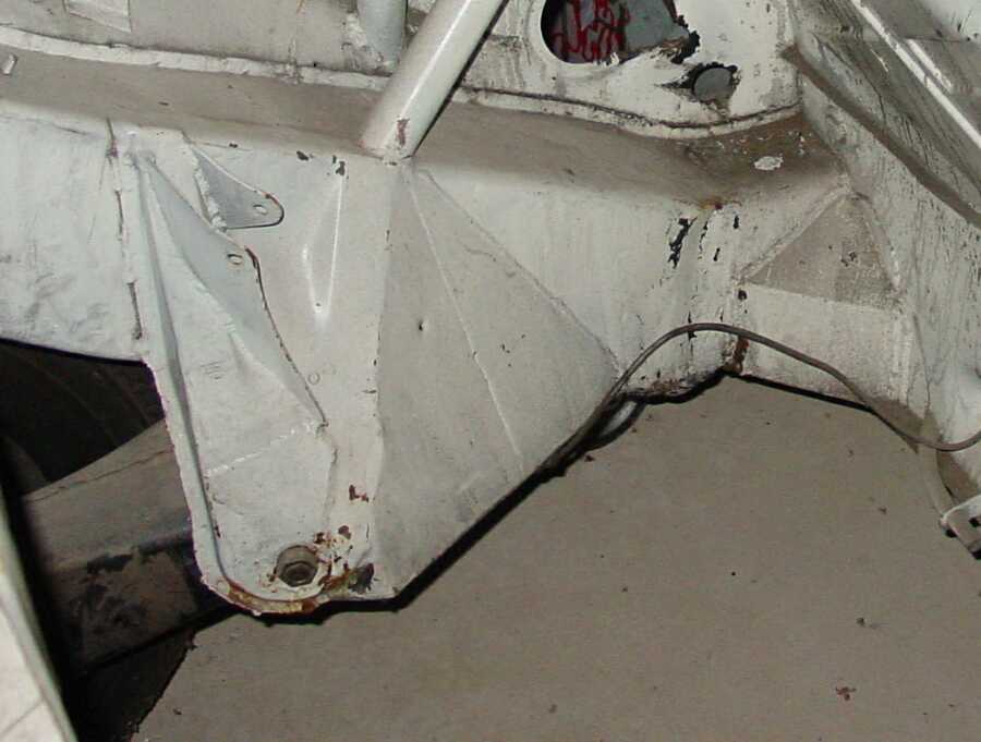

gms
Feb 27 2011, 09:49 AM

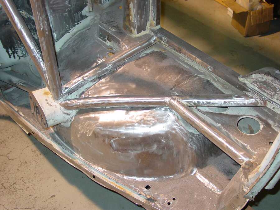

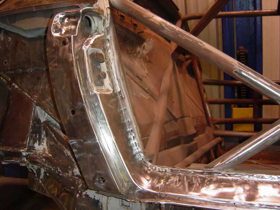

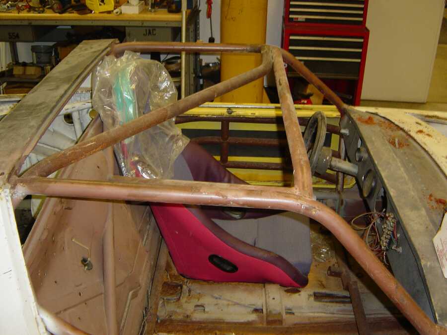

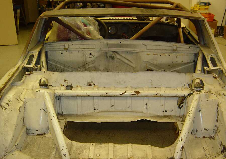

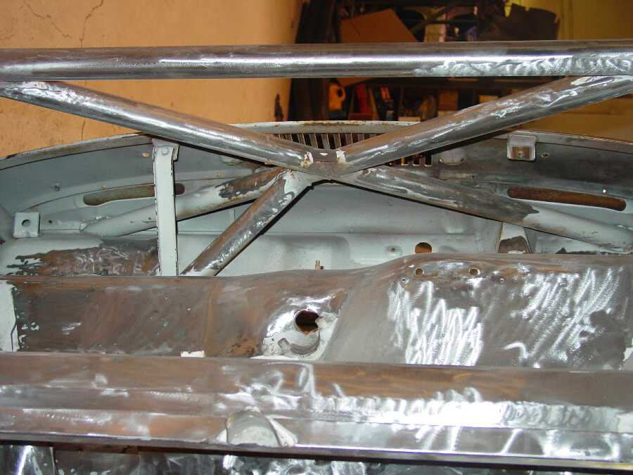

You can see where the cage ties into the front strut
Click to view attachmentDriver's side wheel well needs some holes filled
gms
Feb 27 2011, 09:51 AM
bare ass shot
J P Stein
Feb 27 2011, 10:27 AM
Auggh.....that reminds me of how much work is involved there......but I admire your dedication.
I see you've removed a seemingly redundant tube. I can't wait to see your cleanup of the engine room.

QUOTE(J P Stein @ Feb 27 2011, 10:27 AM)
The bar was removed to work on the trunk floor it will be reinstalled

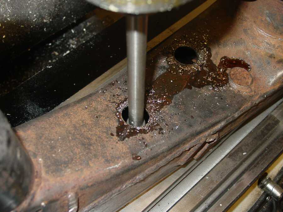

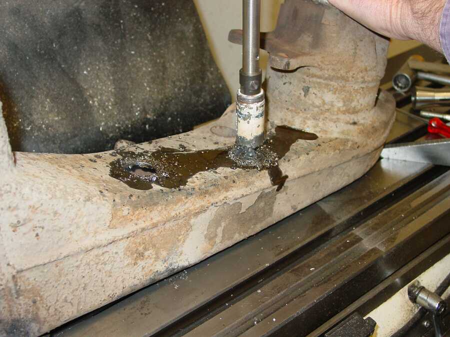

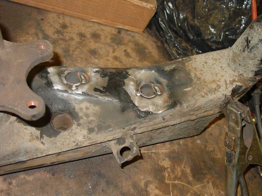

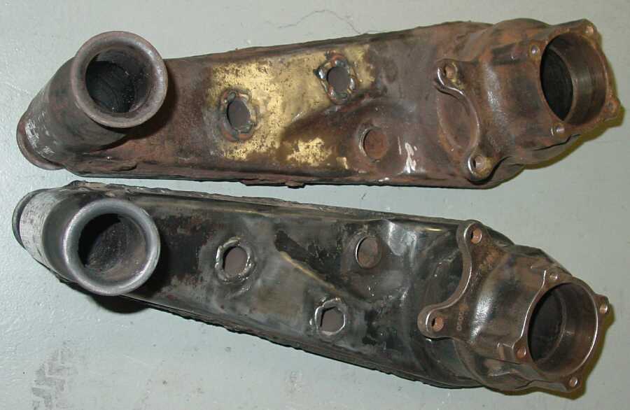

I did some work on the trailing arms a couple weeks ago, stole the idea from Eric.
Mark Kinnaman set the arm up in the mill and punched some 1 inch holes.
gms
Feb 28 2011, 10:46 AM
I found some 1" pipe at McMaster-Carr
gms
Feb 28 2011, 10:48 AM
insert in the holes, weld and there they are.
I will do a little clean up before sending out for powder coating

stugray
Mar 9 2011, 01:17 PM
"I started to strip the passenger front wheel haus and weld all the unnecessary holes (there are many)"
I need to weld some "unnecessary" holes in mine as well.
How do you do it?
I was considering holding a copper penny or a piece of aluminum behind the hole, then plug welding it.
The weld wouldnt stick to the backup that way, but would cause a lot of porosity.
Do you have any tricks to make it flat? I dont want to just keep making the holes bigger and have a mess on my hands.
Nice job on the trailing arms.
I just did that last weekend.
I used a 1" type of pipe that is architectural for handrails.
It has a perfect OD and no seam.
I used that pipe for the rear suspension ear heim joint support as well.
I am surprised that this car does not already have them.
Stu
QUOTE(stugray @ Mar 9 2011, 01:17 PM)
How do you do it?
I find that pulling the welder away from the work cools the weld, in other words i get a long wire pushing into the work in a circular motion. it helps to hit a couple quick tack weld and start from a thicker surface.

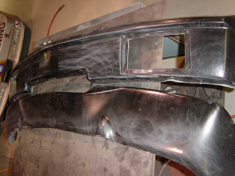

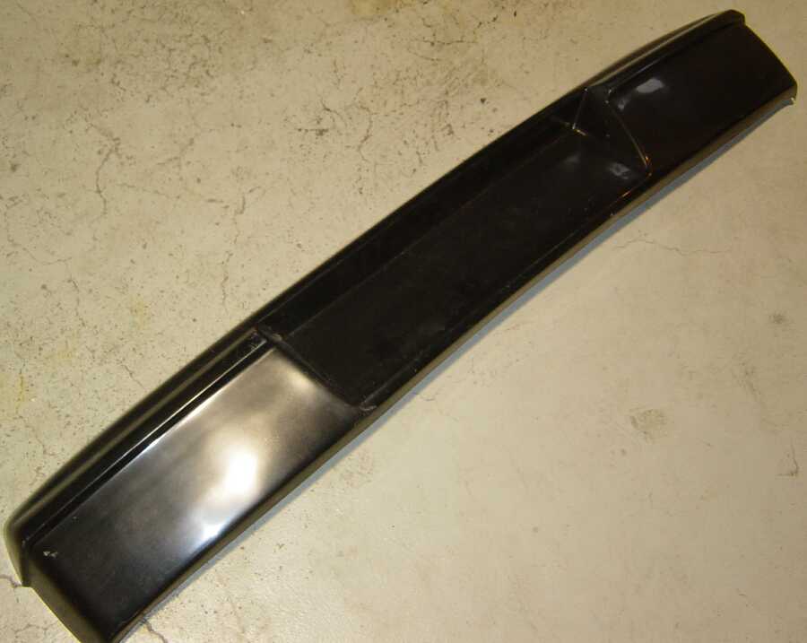

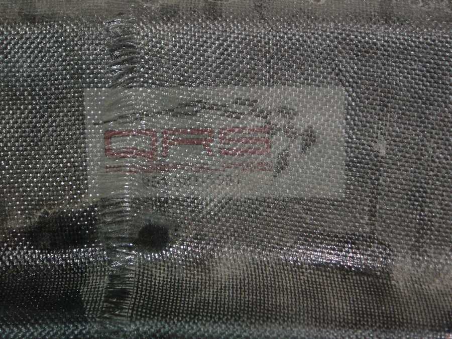

The QRS fiberglass bumpers came in this week, these are nice and light weight!
Click to view attachmentClick to view attachmentClick to view attachment

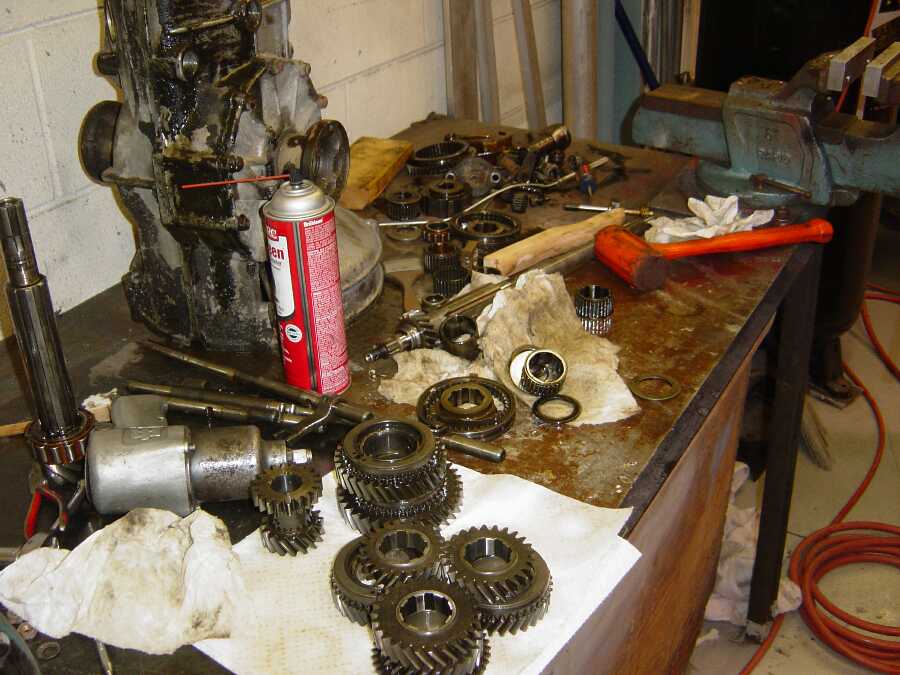

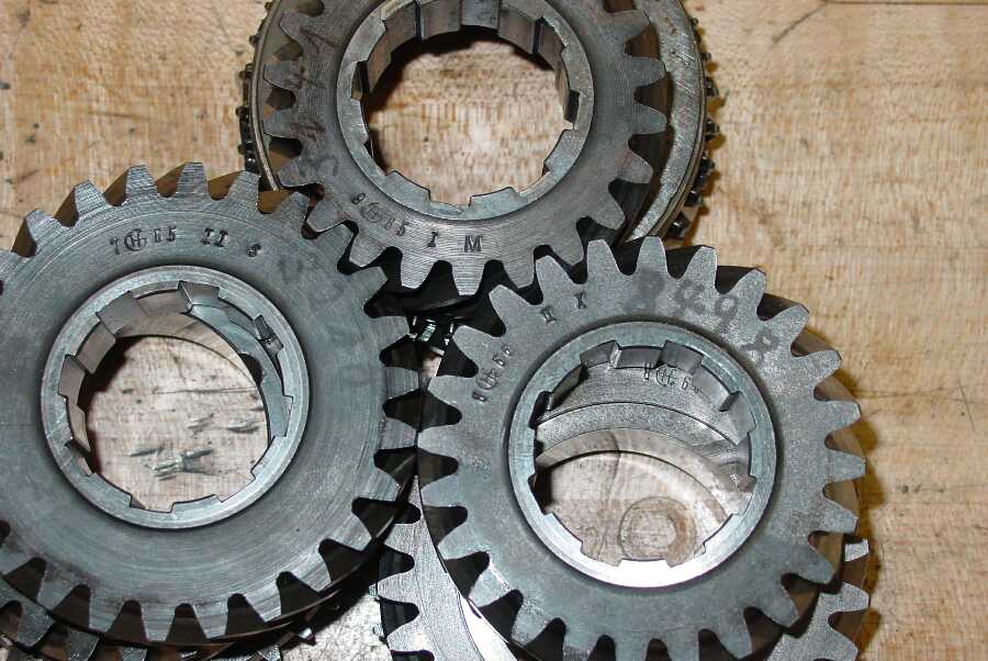

a tranny I bought came in today and I harvested M-S-X gears from it!

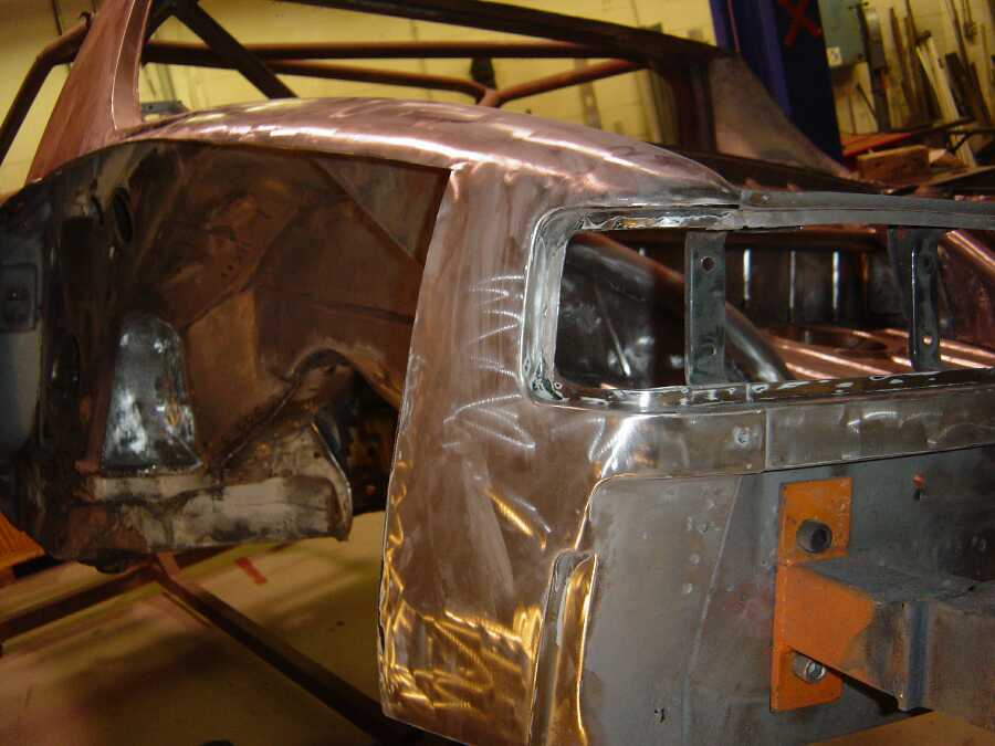

Mark and I got the car on the rotisserie tonight

I did a little paint removal yesterday, very clean longs!

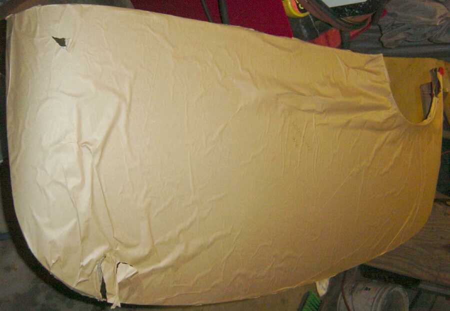

First is the Ginther windscreen

The Ginther screen is tough to find....in my experience and un-cheep.
Be careful handling it while fitting. I was & still managed to crack it.
I've not seen one F/S for 4-5 years....extra careful.

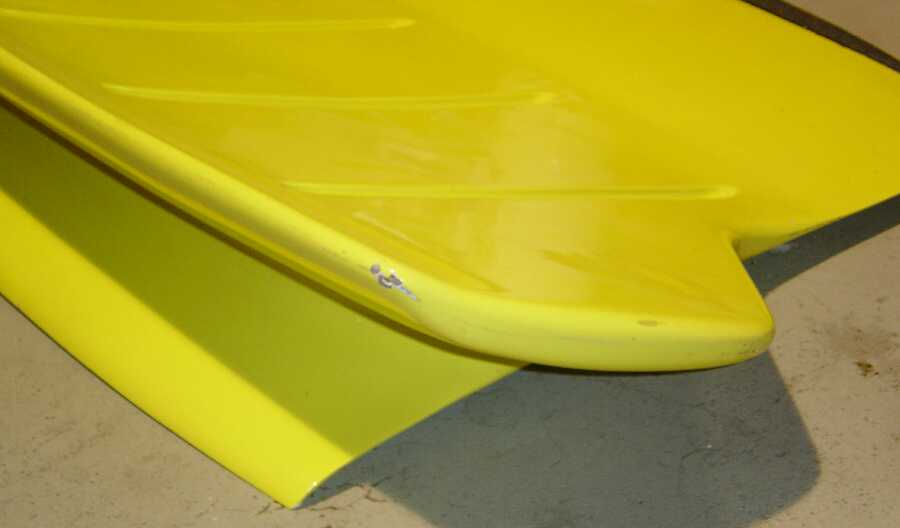

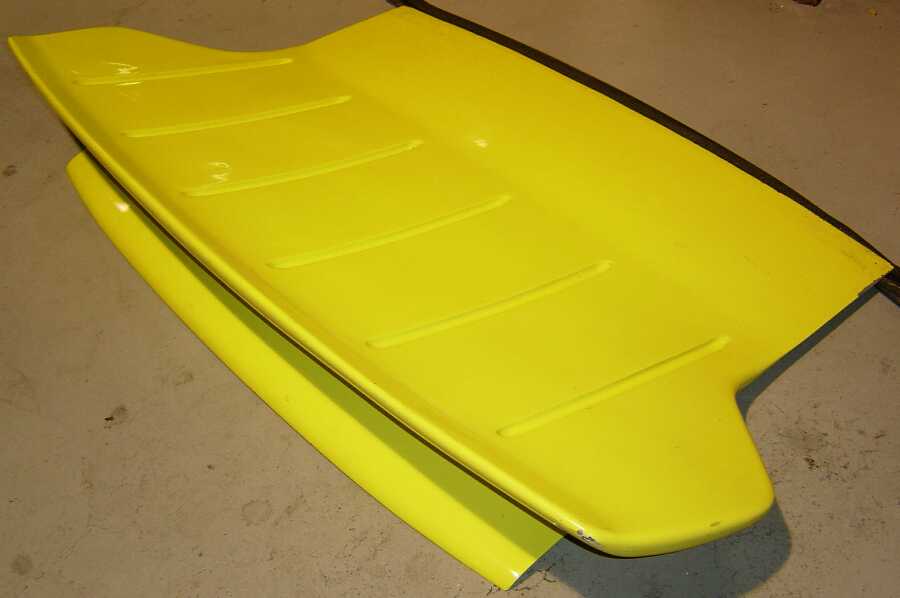

Hello, where did you find your 'whale tail'? I'd like to have one for my 914.
strawman
Nov 8 2011, 01:03 PM
I've got that exact same whale tail that I won't be using. PM me if you're interested. Located in Davis, CA (just outside of Sacramento).

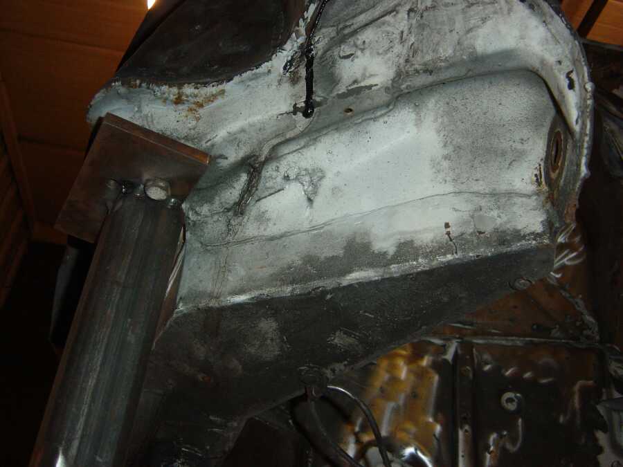

Jun 14 2012, 10:41 PM

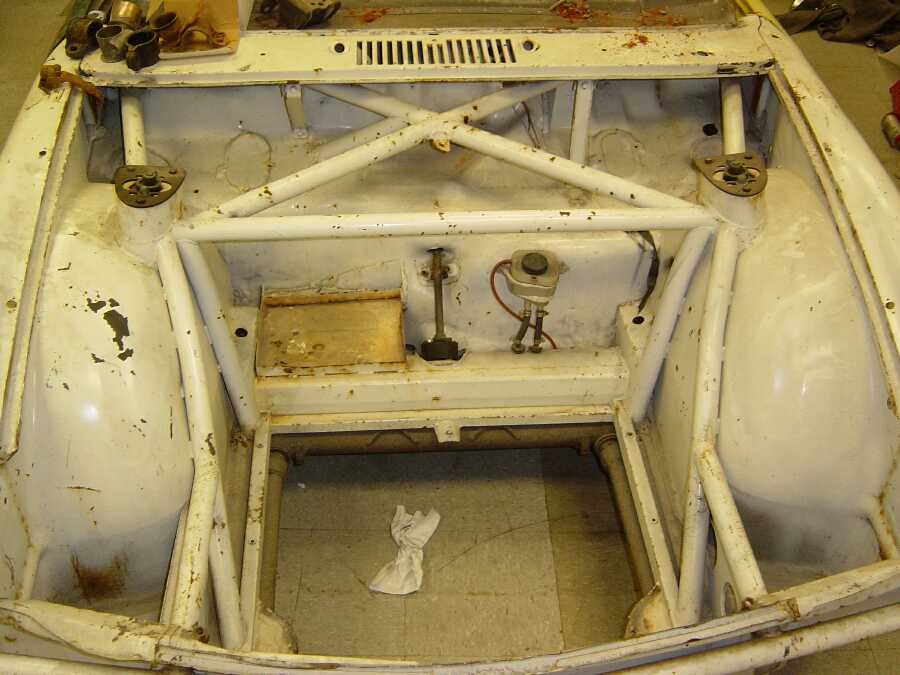

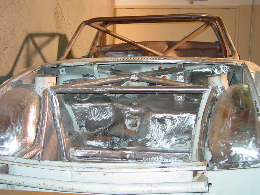

I started work on the car again, got most of the front trunk cleaned up tonight.
Lots of holes to weld up!
Bartlett 914
Jun 15 2012, 09:04 AM
Your car is coming along great.
Glenn has spent countless hours prepping this car ans is very detail minded. The appearance of rust is a problem with the lighting. Most of what looks like surface rust is not. It is nice clean and shinny! The roll bars are painted brown.
