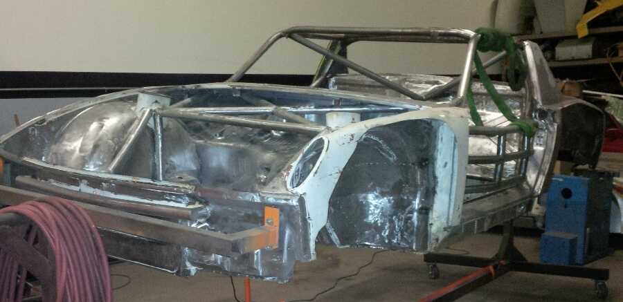

It will probably be blasted before I primer, I am cleaning areas to fill holes and other small changes...I don't want to have to blast it twice.

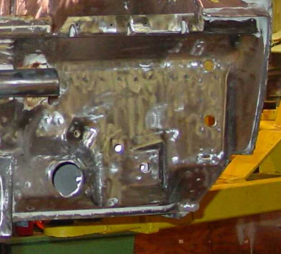

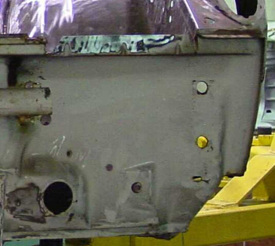

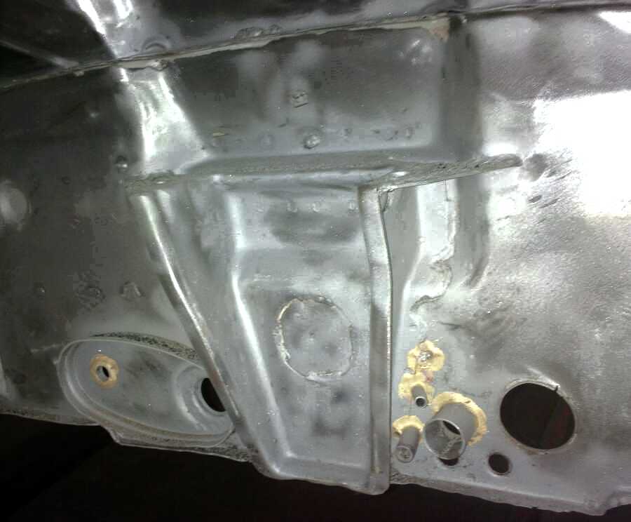

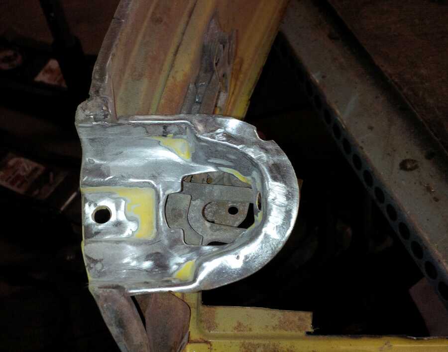

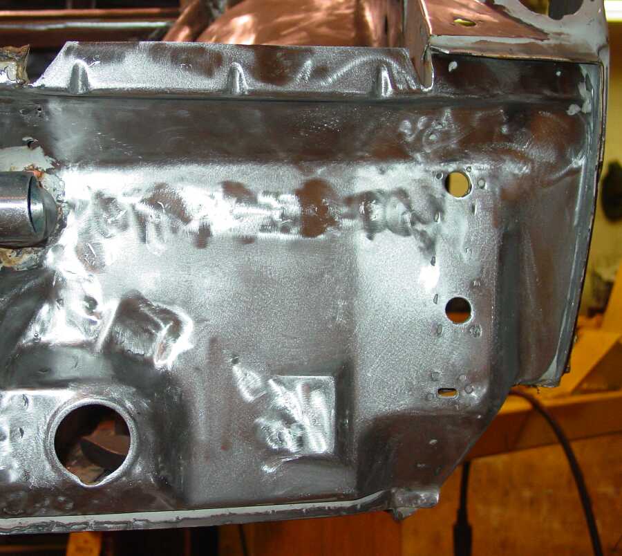

This is an example of some of the work I did yesterday.
I removed the horn and fog light mounts and filled the holes.
Clean the paint off
Weld up the holes

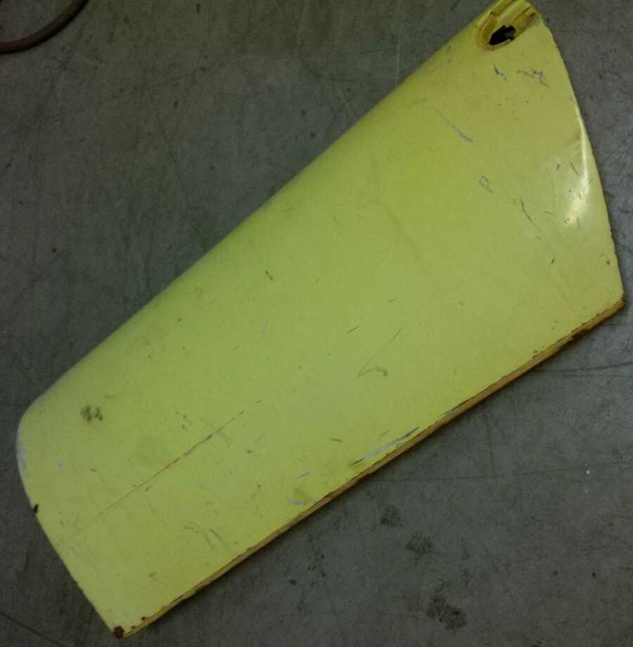

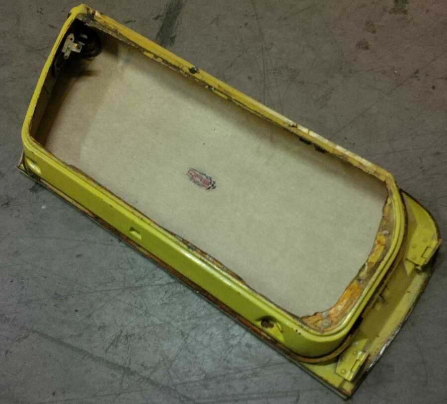

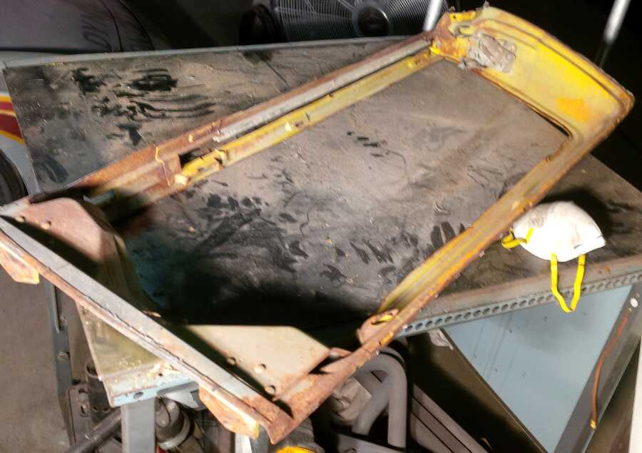

I had an early door with a bad door skin (rust & bondo) so I thought I would try and re-skin it with fiberglass.
gms
The skin came off easier than i thought
gms
I will use a 3M glue to refasten the fiberglass skin

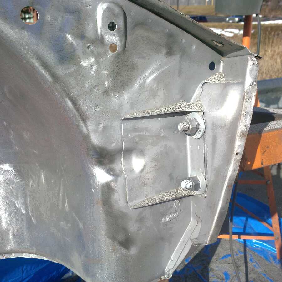

Finally had a warm (41 degrees) dry day on Saturday so I pushed the chassis out side and sand blasted some hard to clean areas
GeorgeRud
It's hard to know what I dislike more, the cold or sandblasting outside of a cabinet! Dealing with both of them at the same time should get you some kudos for getting the job done!
