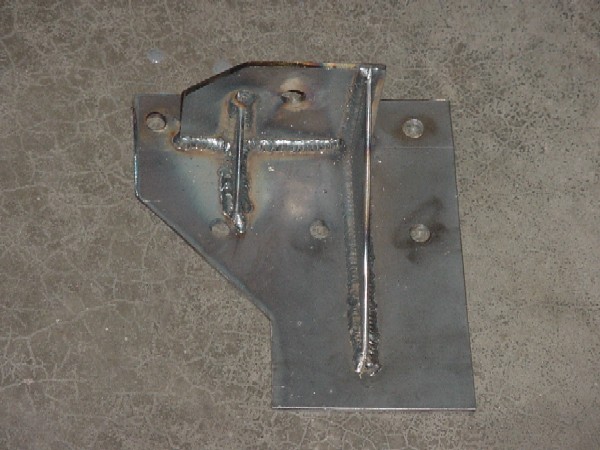

OK I got my Maddog mount and it looks like I am still having to do more than just weld it in!
What did you guys do with the Brake Proportioning Valve? Also, how high do I mount this? It looks like it will have to be high to clear the heater pulls?

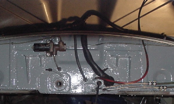

McMark   70-74 cars have the P-valve mounted on this rib.   Feb 28 2011, 06:30 PM

McMark   If you wanna move your P-valve, I'm happy to p...   Feb 28 2011, 11:19 PM
Jeffs9146   If you wanna move your P-valve, I'm happy to ...   Feb 28 2011, 11:50 PM
maddog   Jeff, You are correct, you will have to re-locate...   Mar 1 2011, 06:08 AM
McMark   The top mounting hole is about 1.5" down from...   Mar 1 2011, 11:05 AM
Jeffs9146   The top mounting hole is about 1.5" down fro...   Mar 1 2011, 11:41 AM
McMark   ;)   Mar 1 2011, 11:57 AM
Eric_Shea   Dave, for your documentaion, a lot of 74 cars have...   Mar 1 2011, 04:22 PM

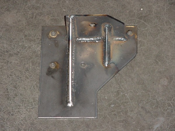

Jeffs9146   After spending some time test fitting and cutting ...   Mar 1 2011, 09:15 PM
Jeffs9146   Here is a914guys for comparison! Maddogs woul...   Mar 1 2011, 09:23 PM

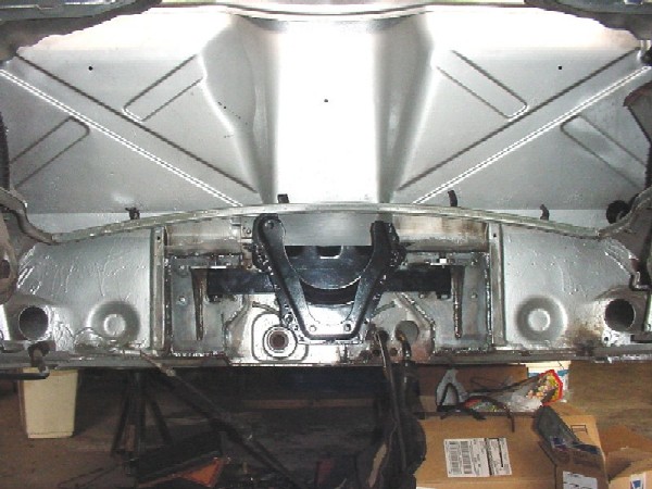

Jeffs9146   Well, here it is installed with the first coat of ...   Mar 4 2011, 10:58 AM

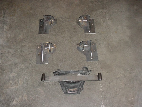

Jeffs9146   Todays progress! I have now installed the ear...   Mar 7 2011, 08:07 PM

Jeffs9146   Everyone told me to mount it 7" from the bott...   Mar 7 2011, 10:10 PM
Jeffs9146   I know, I had to trust those who posted the 7...   Mar 7 2011, 11:35 PM
