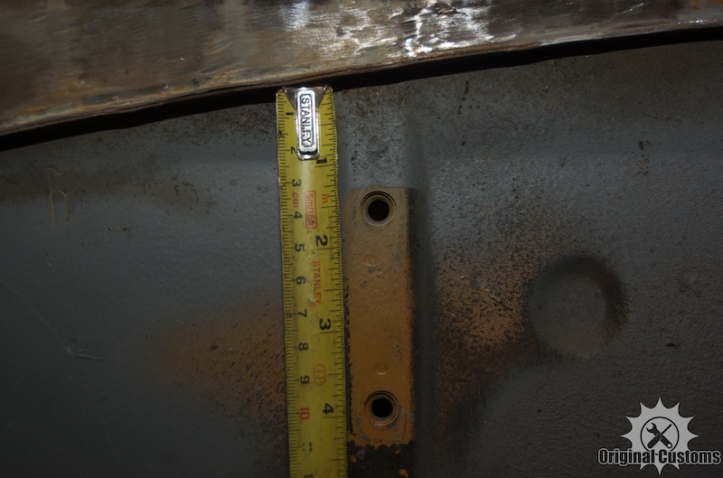

McMark   The top mounting hole is about 1.5" down from...   Mar 1 2011, 11:05 AM
Jeffs9146   The top mounting hole is about 1.5" down fro...   Mar 1 2011, 11:41 AM

kconway   Can anybody provide the dimension from the top of ...   Mar 7 2011, 09:58 PM
moparrob   Can anybody provide the dimension from the top of...   Mar 7 2011, 10:42 PM
kconway   Can anybody provide the dimension from the top o...   Mar 7 2011, 11:09 PM
Jeffs9146   Everyone told me to mount it 7" from the bott...   Mar 7 2011, 10:10 PM
Jeffs9146   I know, I had to trust those who posted the 7...   Mar 7 2011, 11:35 PM
