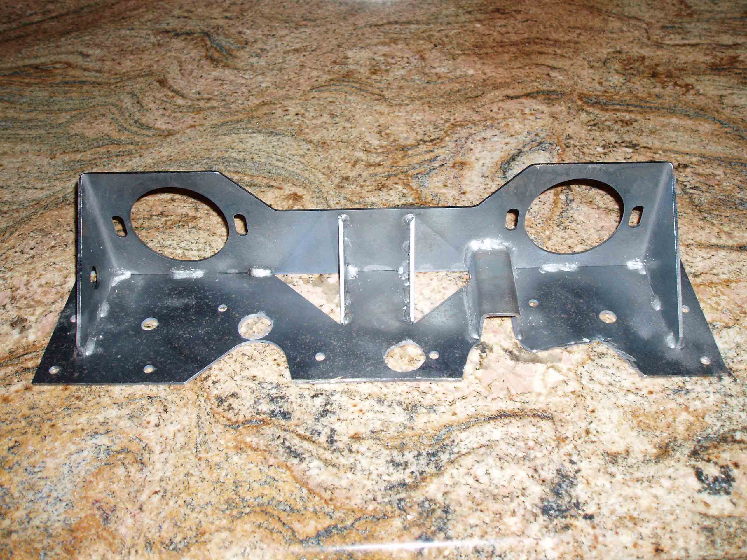

OK I got my Maddog mount and it looks like I am still having to do more than just weld it in!
What did you guys do with the Brake Proportioning Valve? Also, how high do I mount this? It looks like it will have to be high to clear the heater pulls?

After spending some time test fitting and cutting this is what I ended up with!
It was way to much work and I should have just purchased the one made by a914guy.
It would have much easier and it would be done by now.

Jeffs9146   After spending some time test fitting and cutting ...   Mar 1 2011, 09:15 PM
Jeffs9146   Here is a914guys for comparison! Maddogs woul...   Mar 1 2011, 09:23 PM
