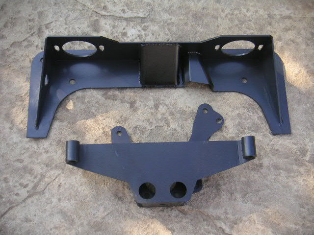

OK I got my Maddog mount and it looks like I am still having to do more than just weld it in!
What did you guys do with the Brake Proportioning Valve? Also, how high do I mount this? It looks like it will have to be high to clear the heater pulls?

Here is a914guys for comparison!
Maddogs would be fine for 70-74, If you added the instructions on drilling the new holes and cutting off the bottom it would probably be OK. I would also say that a little wider on the wire bracket would allow you to replace the harness if need be! The way it is now the harness will not be able to be removed if there is a problem!

maddog   Jeff, You are correct, you will have to re-locate...   Mar 1 2011, 06:08 AM
McMark   The top mounting hole is about 1.5" down from...   Mar 1 2011, 11:05 AM

Jeffs9146   After spending some time test fitting and cutting ...   Mar 1 2011, 09:15 PM
Jeffs9146   Here is a914guys for comparison! Maddogs woul...   Mar 1 2011, 09:23 PM
Jeffs9146   Well, here it is installed with the first coat of ...   Mar 4 2011, 10:58 AM
Jeffs9146   Todays progress! I have now installed the ear...   Mar 7 2011, 08:07 PM
