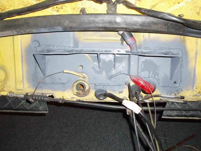

OK I got my Maddog mount and it looks like I am still having to do more than just weld it in!
What did you guys do with the Brake Proportioning Valve? Also, how high do I mount this? It looks like it will have to be high to clear the heater pulls?

Well, here it is installed with the first coat of primer!! (IMG:style_emoticons/default/piratenanner.gif)
All in all it seems to fit fine. It is a bit tight around the harness and could cause some chaifing over time and I did some significant modification to make it fit but I think it will work fine!

McMark   70-74 cars have the P-valve mounted on this rib.   Feb 28 2011, 06:30 PM
Jeffs9146   So what should I do for my 75? :idea: Maddog adve...   Feb 28 2011, 06:35 PM
MDG   So what should I do for my 75? :idea: Maddog adv...   Feb 28 2011, 06:54 PM
SLITS   Depending upon what you are going to run .... Car...   Feb 28 2011, 06:39 PM

Jeffs9146   7" would put the lower part of the mount be...   Feb 28 2011, 06:51 PM
SLITS   7" would put the lower part of the mount b...   Feb 28 2011, 07:09 PM

maddog   Jeff, You are correct, you will have to re-locate...   Mar 1 2011, 06:08 AM
McMark   The top mounting hole is about 1.5" down from...   Mar 1 2011, 11:05 AM
Jeffs9146   The top mounting hole is about 1.5" down fro...   Mar 1 2011, 11:41 AM

Jeffs9146   After spending some time test fitting and cutting ...   Mar 1 2011, 09:15 PM
Jeffs9146   Here is a914guys for comparison! Maddogs woul...   Mar 1 2011, 09:23 PM
