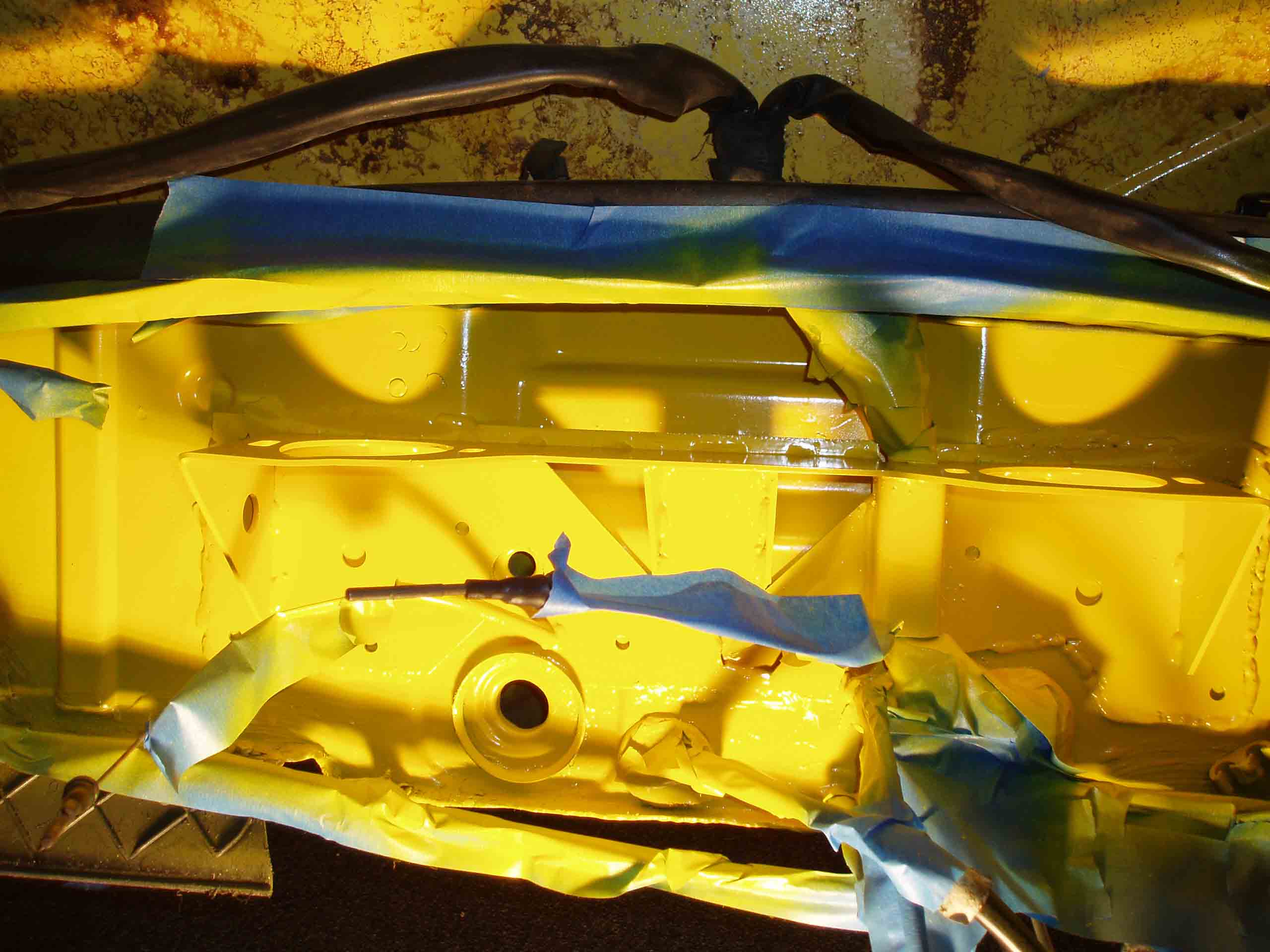

OK I got my Maddog mount and it looks like I am still having to do more than just weld it in!
What did you guys do with the Brake Proportioning Valve? Also, how high do I mount this? It looks like it will have to be high to clear the heater pulls?

I have now installed the early brake lines and I am trying to find the right rivet-nuts to move the Pressure Regulator!

McMark   70-74 cars have the P-valve mounted on this rib.   Feb 28 2011, 06:30 PM
Jeffs9146   So what should I do for my 75? :idea: Maddog adve...   Feb 28 2011, 06:35 PM

SLITS   Depending upon what you are going to run .... Car...   Feb 28 2011, 06:39 PM

Jeffs9146   7" would put the lower part of the mount be...   Feb 28 2011, 06:51 PM
SLITS   7" would put the lower part of the mount b...   Feb 28 2011, 07:09 PM

Eric_Shea   They are basically. All copies of the Vellious ...   Feb 28 2011, 07:58 PM

Eric_Shea   Mock install the lines and let them be your guid...   Feb 28 2011, 08:14 PM

Eric_Shea   Hmmmmmmmm... hard to say with that one. As you ...   Feb 28 2011, 08:21 PM
SLITS   I've had both the RJ and the Maddog .... nothi...   Feb 28 2011, 08:42 PM
John   I made my own bulkhead mount. It's easy espec...   Feb 28 2011, 09:54 PM

Jeffs9146   Interesting!! I guess I could cut the Mad...   Feb 28 2011, 11:15 PM
John   Interesting!! I guess I could cut the Ma...   Feb 28 2011, 11:39 PM

maddog   Jeff, You are correct, you will have to re-locate...   Mar 1 2011, 06:08 AM
McMark   The top mounting hole is about 1.5" down from...   Mar 1 2011, 11:05 AM
Jeffs9146   The top mounting hole is about 1.5" down fro...   Mar 1 2011, 11:41 AM

Eric_Shea   Dave, for your documentaion, a lot of 74 cars have...   Mar 1 2011, 04:22 PM
Jeffs9146   After spending some time test fitting and cutting ...   Mar 1 2011, 09:15 PM
Jeffs9146   Here is a914guys for comparison! Maddogs woul...   Mar 1 2011, 09:23 PM
Jeffs9146   Well, here it is installed with the first coat of ...   Mar 4 2011, 10:58 AM
Jeffs9146   Todays progress! I have now installed the ear...   Mar 7 2011, 08:07 PM

kconway   Can anybody provide the dimension from the top of ...   Mar 7 2011, 09:58 PM
moparrob   Can anybody provide the dimension from the top of...   Mar 7 2011, 10:42 PM
kconway   Can anybody provide the dimension from the top o...   Mar 7 2011, 11:09 PM
Jeffs9146   Everyone told me to mount it 7" from the bott...   Mar 7 2011, 10:10 PM
Jeffs9146   I know, I had to trust those who posted the 7...   Mar 7 2011, 11:35 PM
