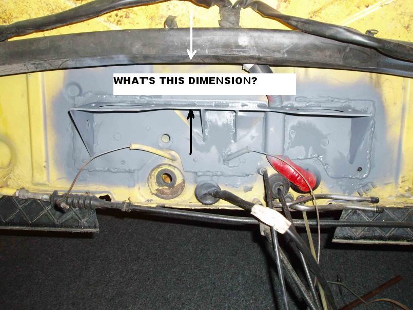

Can anybody provide the dimension from the top of the bracket to the engine shelf?
Kev
Kev
(IMG:http://www.914world.com/bbs2/uploads_offsite/i954.photobucket.com-11663-1299559327.1.jpg)

kconway   Can anybody provide the dimension from the top of ...   Mar 7 2011, 09:58 PM
moparrob   Can anybody provide the dimension from the top of...   Mar 7 2011, 10:42 PM
kconway   Can anybody provide the dimension from the top o...   Mar 7 2011, 11:09 PM
Jeffs9146   Everyone told me to mount it 7" from the bott...   Mar 7 2011, 10:10 PM
Jeffs9146   I know, I had to trust those who posted the 7...   Mar 7 2011, 11:35 PM
