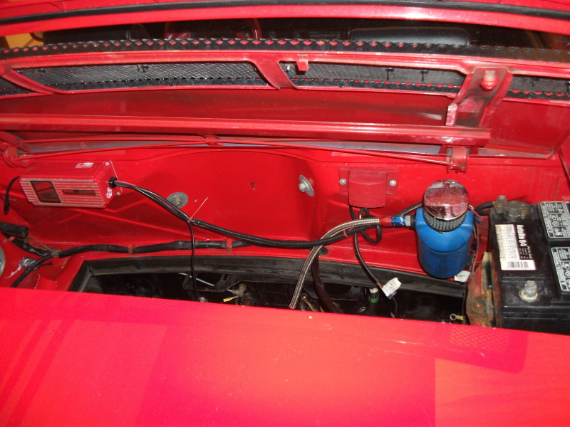

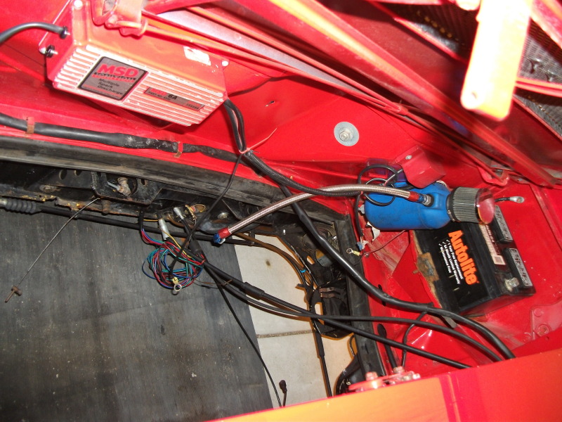

I'm baaaack.
Hi everybody. Maybe some of your remember me. I was very active on the 914 forums about ten years ago. I rebuilt my 1.7 fi 73 914 into a Dell Orto carbed, high compression, big cammed, 2.0 liter. Tom Gould, Wayne Dempsey, and I built the motor in Wayne's Manhattan Beach apartment garage. Gill Paszek helped me with the five lug conversion, and numerous other projects like a passenger footwell sub woofer. I also mounted BMW 320i front brakes, thru the body roll bars, and fuchs replicas. I had the engine compartment and body painted Gaurds Red. John Larson of West Coast Garage rebuilt my 901 tranny and helped me keep the car running, cause I drove it like I stole it.
Driving the car was a blast for the past ten years. I blew the engine twice, once with a blown head gasket, and another dropped valve seat, (my second). EMS wanted $800 to fix the head this time, so I decided it's time. I've been wanting to do the six conversion for over ten years, so I'm finally going to do it. I actually started a few months ago. I thought I should do a conversion thread. Six conversion threads used to be very plentiful, but I don't see so many anymore. I would appreciate links, cause I'm gonna need a lot of information, advice, and of course, parts. Here is the car now, well I've removed the 2.0 liter motor.
Bee Jay

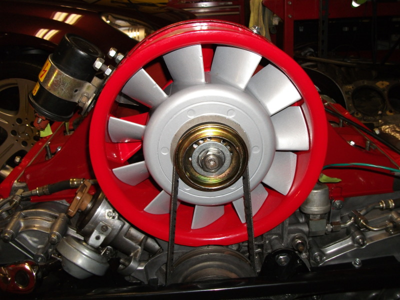

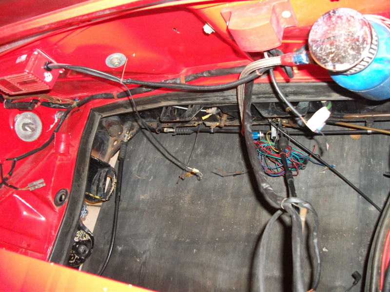

I didn't get much done this weekend. Lot's of honey do's around the house and I spent Sunday in LA at the Dunkel Brothers swap meet. No, I didn't find any carbs. I got the fan belt on and fairly tight. Another job that sounds soooo easy whenever it's written. The alternator nut cost me $26, damn. Since I'm almost ready to put the engine in, I washed the engine compartment. Doesn't look like much, but it's much better than when I started. I saw a few very motivating 914-6 at the swap meet and car show. I can't hardly wait to get this thing running. I'll get to drive it to next years Dunkel Bros. Actually it's not called Dunkel Bros. anymore, but ....whatever.
Bee Jay
