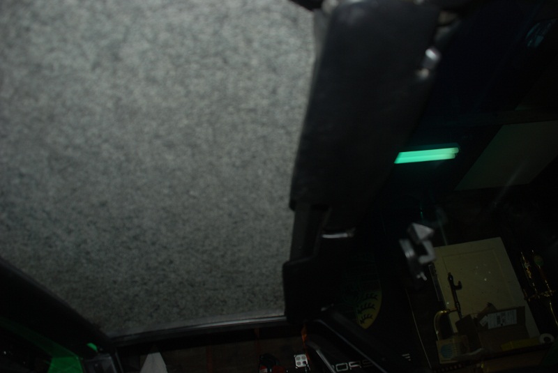

I found some really nice (as close to NOS as you can get) sun visors at the German swap meet this weekend:

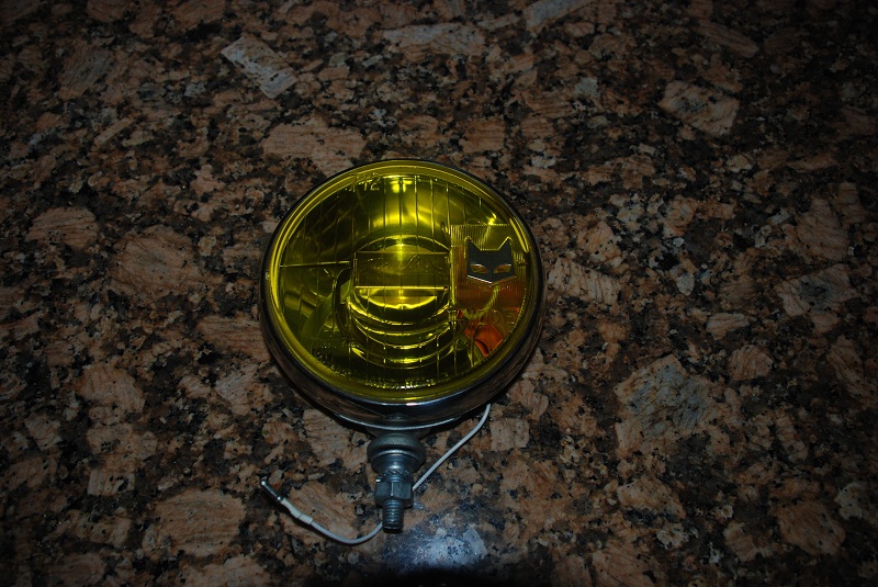

The NOS Marchal fog lights/driving lights, I also picked up some covers for them at the lit show over the weekend:
