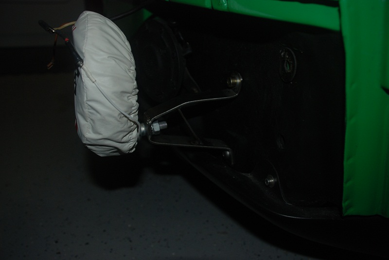

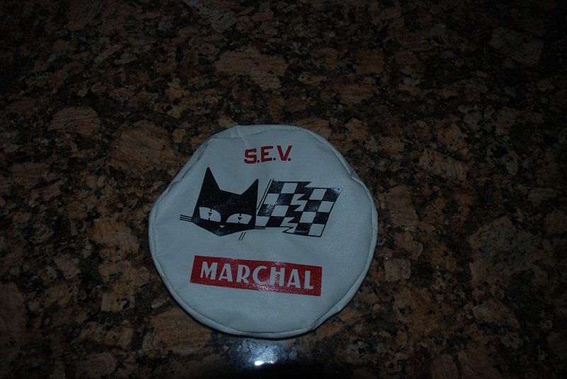

proto31   I found some really nice (as close to NOS as you c...   Mar 7 2011, 11:45 PM
proto31   Some more: Installed without bumper, stainless ...   Mar 7 2011, 11:48 PM
