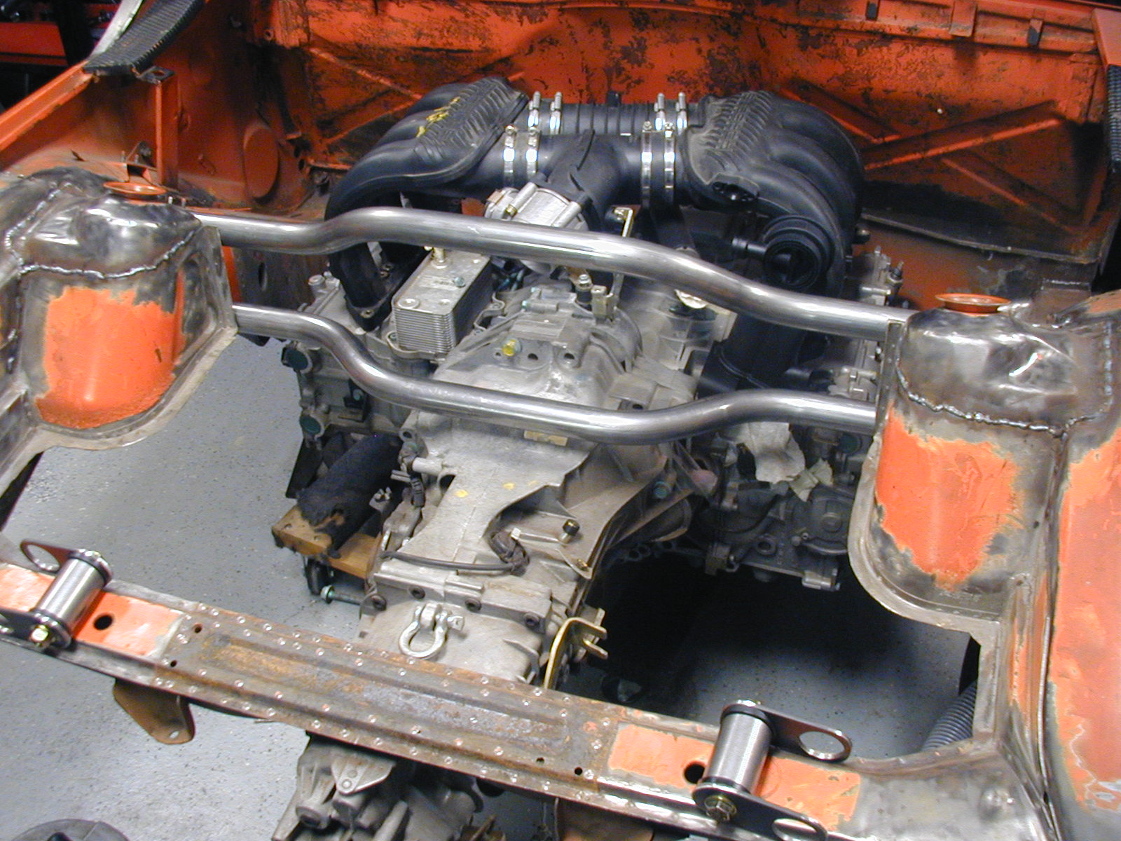

Hey Joe, you mean like this?
I am not using a 986 suspension but am using the 2.7 and cable shifted 5 speed. Rich Johnson built the mount for the nose of the engine, and we used his firewall setup along with it. It fits good but I am modifying the trailing arms to increase space around the coil-on-plug and inner suspension ears. I have alot more pics I have been meaning to post in a build thread but other stuff seems to get in the way. There are similiar projects out there I dont think any are completed yet. I say go for it!
