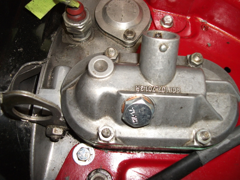

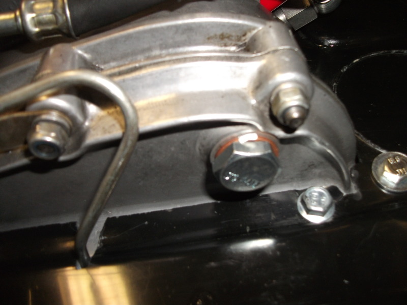

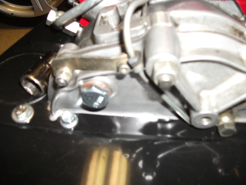

QUOTE(moparrob @ Feb 27 2011, 08:36 PM) *
I'm looking forward to hearing how you end up dealing with those sensors, since I have a '79 3.0 with the same exact sensors - and I am also going with Webers and MSD.
I bought three of these from NAPA. Oil Drain Plug part # 704-1379. $2.00 each, comes with crush washers. How does it look?
