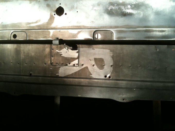

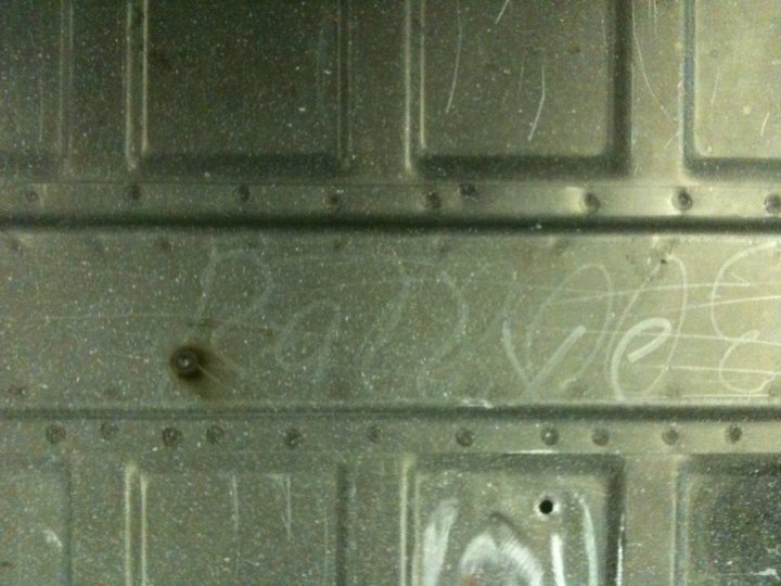

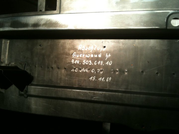

looks great, here are my fav. soda blast pics , real factory GT 705, There is another on the dash but the pic is on RoadGlue.

sixnotfour   looks great, here are my fav. soda blast pics , re...   Mar 20 2011, 02:51 PM

Eric_Shea   Oh yeah, those rock. I remember that... :trophy...   Mar 20 2011, 05:53 PM
