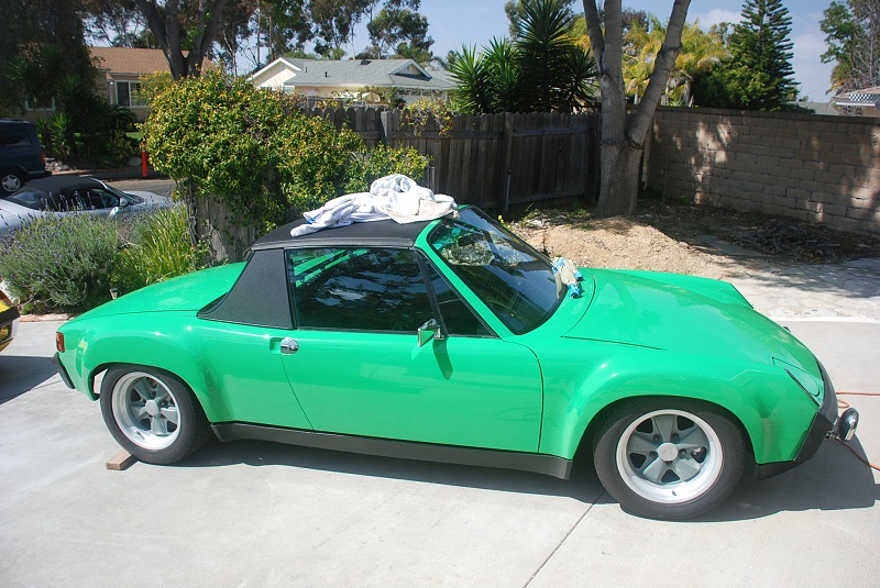

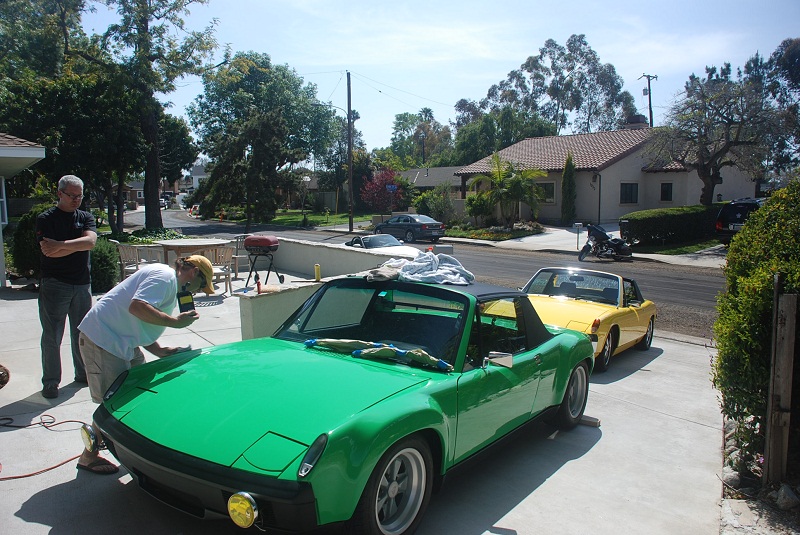

proto31   Some updates, Socal Andy came down and polished my...   Mar 20 2011, 09:02 PM
