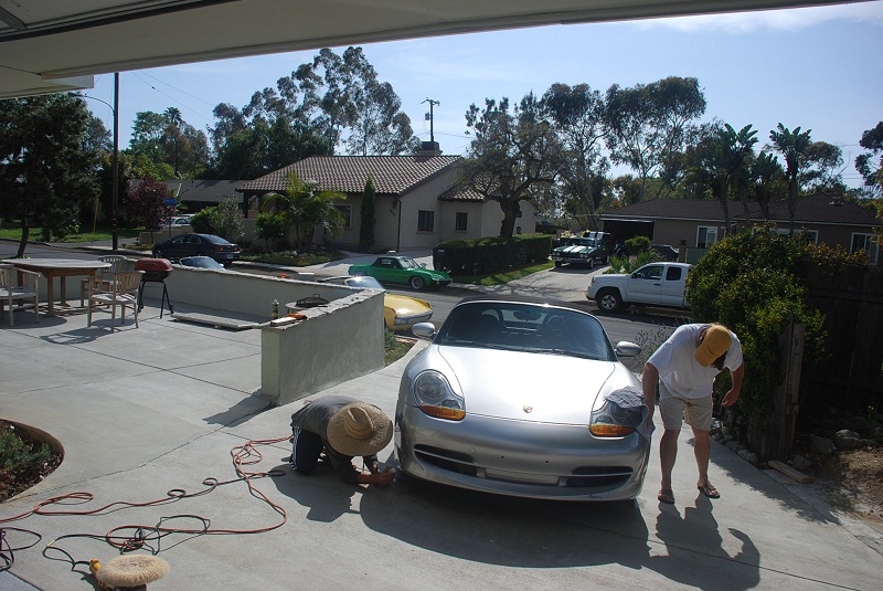

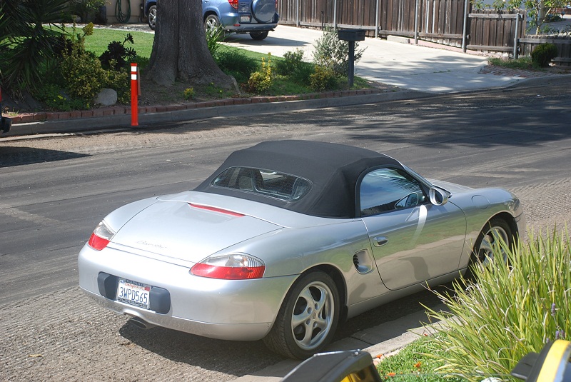

Thomas' car, a really nice 97' with a GT3 front bumper, he's taking it back to Germany with him. If you look carefully, you should be able to see 4 Porsches in the first pic, my neighbors thought I was running a chop shop in my garage for stolen cars, pretty funny.

proto31   Some updates, Socal Andy came down and polished my...   Mar 20 2011, 09:02 PM
proto31   Thomas' car, a really nice 97' with a GT3 ...   Mar 20 2011, 09:04 PM
