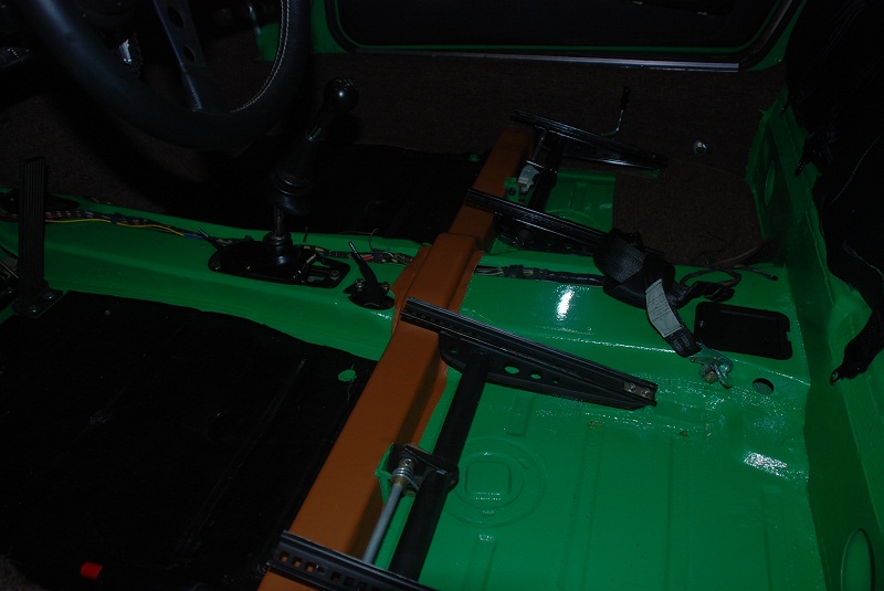

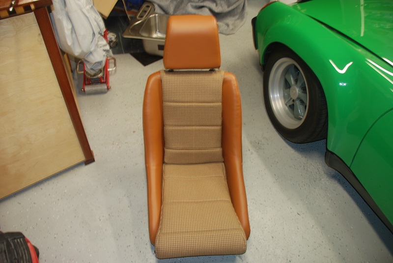

proto31   Dropped the seats, door panels and center armrest ...   Mar 7 2011, 05:02 PM
Ferg   Dropped the seats, door panels and center armrest...   Mar 7 2011, 05:13 PM
MDG   I'm going with Cork (original Porsche color) ...   Mar 7 2011, 06:55 PM

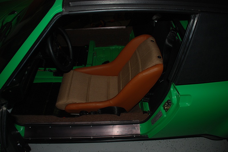

proto31   Received all the interior pieces, seats and door p...   Mar 20 2011, 09:08 PM

proto31   Installed all the carpet, had to remove the steeri...   Mar 20 2011, 09:14 PM
proto31   Thanks for the comments! Here's the inte...   Mar 20 2011, 09:17 PM
