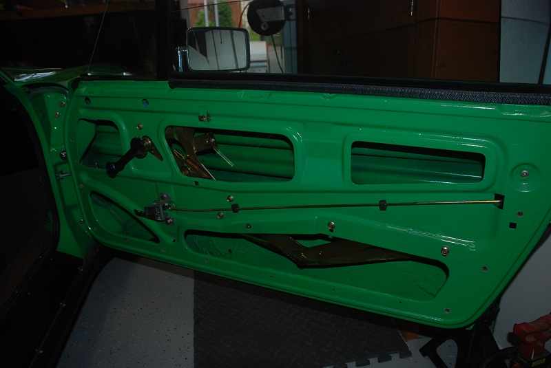

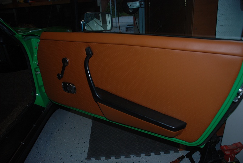

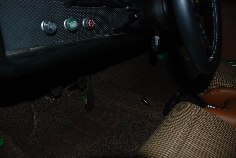

Installed all the carpet, had to remove the steering column so that I didn't have to cut a slit in the carpet set, PITA (IMG:style_emoticons/default/dry.gif)
Passenger door before new panel (IMG:style_emoticons/default/biggrin.gif) :
and after:

proto31   Installed all the carpet, had to remove the steeri...   Mar 20 2011, 09:14 PM
proto31   Thanks for the comments! Here's the inte...   Mar 20 2011, 09:17 PM
